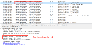

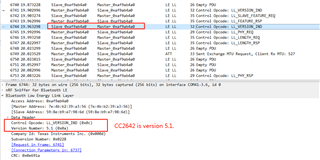

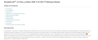

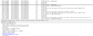

I'm using simplelink_cc13xx_cc26xx_sdk_7_41_00_17 version SDK, I read the description support 5.2 stack, but I see the over-the-air packet capture data is still 5.1 stack
examples:simple_peripheral_oad_onchip
Thank you for highlighting this. There is a ticket filed with R&D and this should be addressed in a future SDK release. In the meantime, this should not prevent you from using the features the device supports or going through certification/production.
