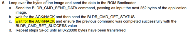

    While reviewing the process of bootloader, we found something weird:
    According to the TRM p470, we saw below procedure:
    We initially expected to receive ACK/NACK after we sent BLDR_CMD_GET_STATUS.
    However, after we sent BLDR_CMD_GET_STATUS, we received 0x03 0x40 0x40, which seemed to be the BLDR_CMD_RET_SUCCESS value.
    We thought there might be something missing.
    1. Could you help us clarify if this was expected behavior of bootloader or was it incorrect?
    2. Plus, we see this description:
    The transmitter is allowed to send zeros until a nonzero response is received, which is necessary for SPI and is allowed by the UART. The receiver is allowed to return zeros until it is ready to ACK or NACK the packet that is being sent. Neither device transfers a nonzero byte until it has received a response after transmitting a packet.
    Does this mean each 0x00 we receive after sending any CMD can be ignored?
    Thanks.
    BR,
    YuWen

  • Dear Sir,
    ACK is returned after every command.
    Then you use BLDR_CMD_GET_STATUS after you receive the ACK, to check the status of the previous command.
    -> I'm still a bit confused.
    We expected to see another ACK/NACK after sending BLDR_CMD_GET_STATUS.
    But we didn't get any ACK/NACK for BLDR_CMD_GET_STATUS.
    We directly get something other than ACK/NACK.
    We thought this was incorrect.
    Could you explain why was this happening?
    Thanks.
    BR,
    YuWen
  • Yes, you should be receiving an ACK/NACK after every command... Can you confirm the CMD ID you are sending for BLDR_CMD_GET_STATUS? Is it 0x21?
    What value do you see from the device after sending BLDR_CMD_GET_STATUS?
    Can you provide logic analyzer shot of the communication wires when the issue happens? Include a few commands also just before the issue happens.
