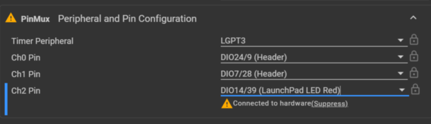

Hi Expert,
want to confirm below due to it's not in example code.
I want to have 3 pwm output with different duty setting. I only want to use 3 channel in LGPT3.
the sysconfig setting is as below.
i can use below to enable 3 channel, right?
PWMTimerLPF3_Object *object = pwm1->object;
object->chNumber = 0;
pwm1 = PWM_open(CONFIG_PWM_0, &params);
if (pwm1 == NULL)
/* CONFIG_PWM_0 did not open */
while (1) {}
object->chNumber = 1;
pwm11 = PWM_open(CONFIG_PWM_0, &params);
if (pwm11 == NULL)
while (1) {}
object->chNumber = 2;
pwm12 = PWM_open(CONFIG_PWM_0, &params);
if (pwm12 == NULL)
while (1) {}
PWM_start(pwm1);
PWM_start(pwm11);
PWM_start(pwm12);
PWM_setDuty(pwm1, duty);
PWM_setDuty(pwm11, duty);
PWM_setDuty(pwm12, duty);
But I cannot get it work. So, I think that I may misunderstand something.

  • Hi Frank,
    Please be aware of this previous E2E thread.
    Regardless of an object's chNumber, PWMTimerLPF3_open -> PWMTimerLPF3_getPwmChannelNo will select the first valid channelConfig[x].pin (from the ti_drivers_config.c generated by SysConfig) as its pwmChannelNo.  Hence your channel 0 (first) may be functional, but channels 1 and 2 will not be.
     *  ======== PWMTimerLPF3_getPwmChannelNo ========
    static LGPTimerLPF3_ChannelNo PWMTimerLPF3_getPwmChannelNo(uint_least8_t index)
        LGPTimerLPF3_HWAttrs const *hwAttrs;
        LGPTimerLPF3_Handle handle;
        LGPTimerLPF3_ChannelNo channelNo;
        handle  = (LGPTimerLPF3_Handle)&LGPTimerLPF3_config[index];
        hwAttrs = handle->hwAttrs;
        /* Find the channel that has been connected to a pin.
         * It's assumed that only one of the ordinary channels have been
         * muxed to a pin.
        if (hwAttrs->channelConfig[0].pin != GPIO_INVALID_INDEX)
            channelNo = LGPTimerLPF3_CH_NO_0;
        else if (hwAttrs->channelConfig[1].pin != GPIO_INVALID_INDEX)
            channelNo = LGPTimerLPF3_CH_NO_1;
        else
            channelNo = LGPTimerLPF3_CH_NO_2;
        return channelNo;
    You will need to copy the source\ti\drivers\pwm\PWMTimerLPF3.c file to your workspace and modify accordingly to meet your specific application needs.
