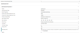

    You should be able to see the extended advertising  on the Simple Link connect as well. I think this is a matter of what PHY is used by the phone for the secondary PHY.
    You can modify this through SysConfig -> BLE -> Advertisement Set - Advertisement Parameters:

  • Hi David,
    i already using as same configuration you provided, but not able to see any advertisement on simple link connect same i can see on nrf connect and where its show primary PHY LE 1M and secondary PHY LE 1M is there anything need to change to view on simple link connect?

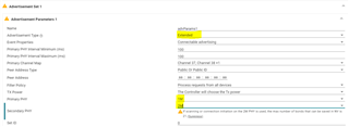

  • Hello Jay,
    I am able to see the 2M PHY extended adv in both apps: SimpleLink and NRF using an iphone 15 (IOs 17.2)
    Are you using SDK version 8.10?
    This is the configuration I used:
    BR,
    David.

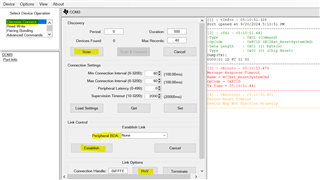

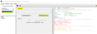

  • Hello Jay,
    I haven't been able to see the extended adv on the Android phone. In the meantime would it be possible to use our internal tool (<SDK>\tools\ble5stack\btool) to scan and perform OAD? You would have to flash the host_test_app.hex (<SDK>\examples\rtos\LP_EM_CC2340R5\ble5stack\hexfiles) into another board to act like central and then scan for the peripheral device.
