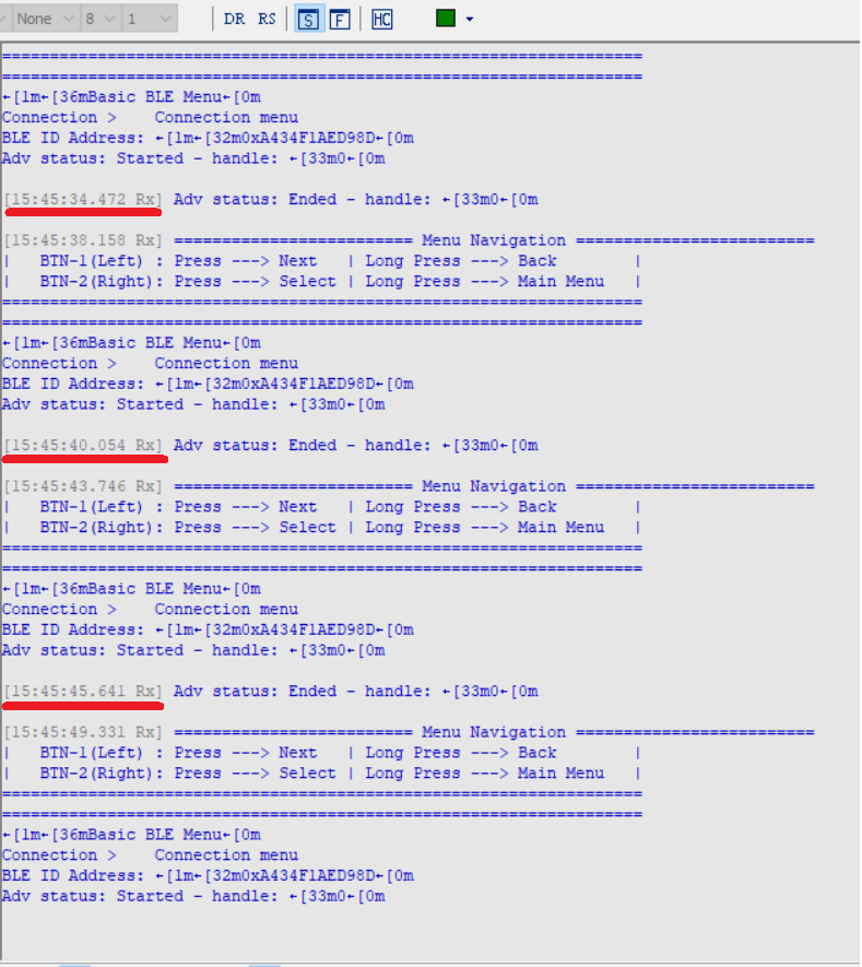

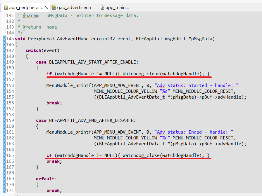

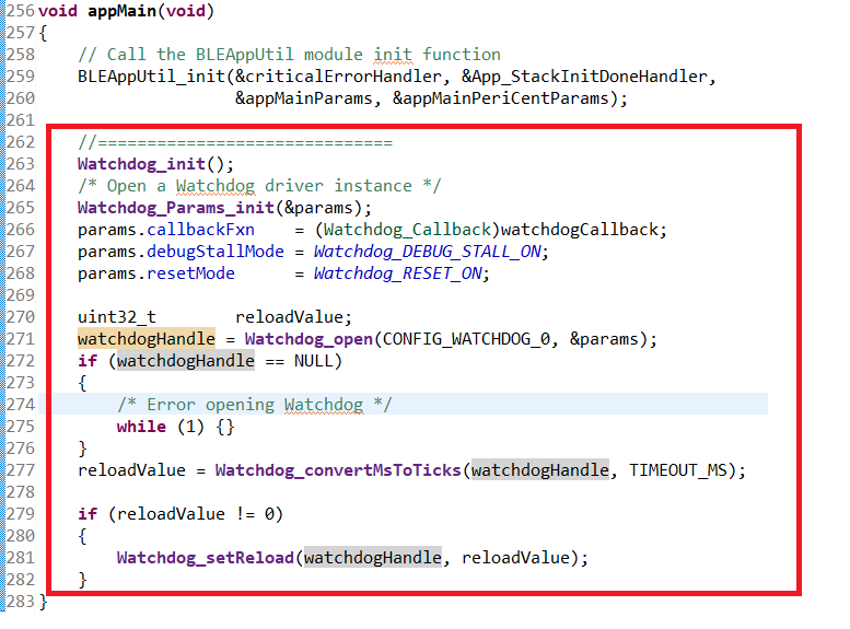

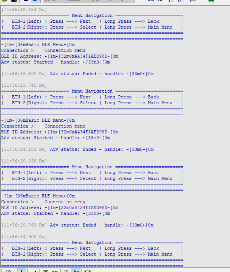

  • Hello Isaac:
        Good Morning!
    As shown in the figure below,(Red frame)
    In the "Advertising End" event, we executed, "Watchdog_close();"
    in theory it should have gone to sleep or idle until woken up.
    But why is the system still "watchdog-reset" after 5.5 seconds? And it keeps repeating.

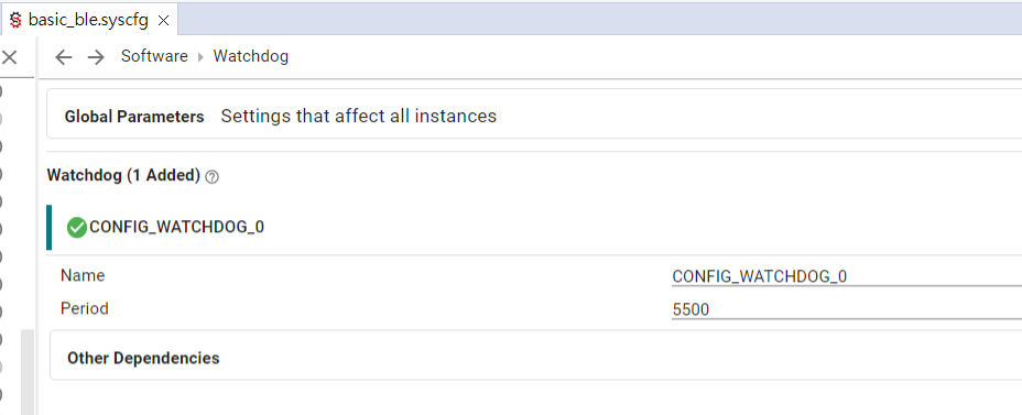

    (P.s. Watchdog Period : 5.5 sec)
    When I changed the "Watchdog period" to "N" seconds, the system reset period was also changed to "N" seconds.
    BR,
    March.

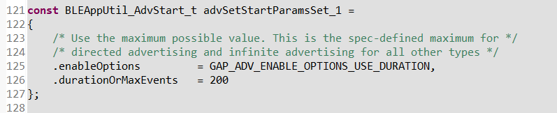

  • Hello March,
    Apologies for the delay in my response. I provided a logic trace earlier in the thread with the outputs I am seeing with your application. I am confused on where you are seeing the watchdog-reset last 5.5 seconds, and more specifically, where you are seeing the watchdog timer reset at all?
    Firstly, with the code that was provided, I do not see the watchdog resetting at all. I see advertisements starting every ~3.5-3.6 seconds, with the advertisements lasting for ~2 seconds, which is configured with the duration. Every time the advertisements end, the watchdog timer is closed. Additionally, the watchdog callback function should be entered every time the watchdog timer initiates a reset, which I am also not seeing.
    Secondly, even if I did see evidence for the watchdog timer resetting, I don't understand where it is being determined that the reset is lasting 5.5 seconds.
    Third, where are you configuring the device to go into standby?
    Please provide a logic trace which includes the traces that I had in mine attached above. Additionally, if you are observing a 5.5-second-long reset, please provide some traces or information on this.
    Isaac

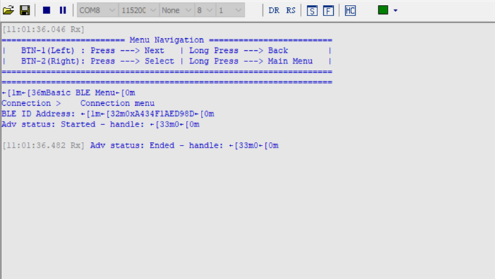

  • Hello  Isaac,
    The Same code example.  (Mike Wu, who provided the code before)
    When I mark the following code.
     * @fn      appMain
     * @brief   Application main function
     * @return  none
    void appMain(void)
        // Call the BLEAppUtil module init function
        BLEAppUtil_init(&criticalErrorHandler, &App_StackInitDoneHandler,
                        &appMainParams, &appMainPeriCentParams);
    //    Watchdog_init();
    //    /* Open a Watchdog driver instance */
    //    Watchdog_Params_init(&params);
    //    params.callbackFxn    = (Watchdog_Callback)watchdogCallback;
    //    params.debugStallMode = Watchdog_DEBUG_STALL_ON;
    //    params.resetMode      = Watchdog_RESET_ON;
    //    uint32_t        reloadValue;
    //    watchdogHandle = Watchdog_open(CONFIG_WATCHDOG_0, &params);
    //    if (watchdogHandle == NULL)
    //        /* Error opening Watchdog */
    //        while (1) {}
    //    reloadValue = Watchdog_convertMsToTicks(watchdogHandle, TIMEOUT_MS);
    //    if (reloadValue != 0)
    //        Watchdog_setReload(watchdogHandle, reloadValue);
    After power on, it will only broadcast once and the UART message will only be displayed once,
    even if it has exceeded 5.5 seconds or even longer.
    When I unmark this code.
    It will broadcast according to the Watchdog period
    Please guide me how to modify this "basic_ble + Watchdog" sample code.
    so that it will no longer wake up the broadcast by itself.
    BR,
    March.

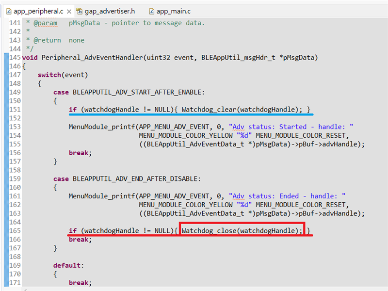

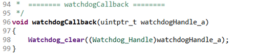

  • March,
    I see. Advertising is set to a duration of 2 seconds, because of the watchdog reset, advertising will begin again for another 2 seconds. Advertising lasts for 2 seconds, after this, the BLEAPPUTIL_ADV_END_AFTER_DISABLE event is raised. When this event occurs, the watchdog timer is cleared. When the watchdog timer is cleared, it begins counting to 5.5 seconds again. When the timer reaches 5.5 seconds, the device resets and advertising begin again.
    Section 8.6 in the datasheet states "Upon counter expiry, the watchdog timer resets...", and "...cannot be stopped once enabled.". Basically, once the watchdog is enabled, you cannot disable it. To reset the watchdog timer, the timer needs to be reloaded every time it nears the timeout time. Clear will clear the timer value, but when this occurs, the timer is reloaded and restarts. To avoid this, try reloading the timer periodically before the timeout occurs.

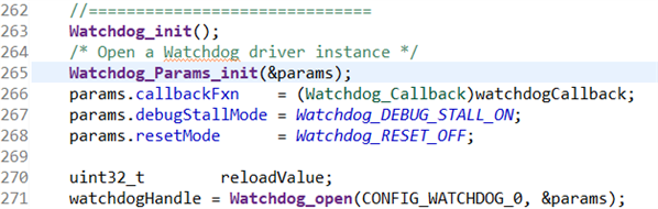

    Another option is using the Watchdog_RESET_OFF resetMode parameter. Instead of initiating a reset, the watchdog timer will generate an interrupt instead of a reset. Within the interrupt you can decide if the device should be reset or keep running. Also, if you want to continuously advertise, you will need to add additional logic. Setting the advertising duration to 200, will advertise for 2 seconds, then stop advertising until advertising is re-enabled.
    Let me know if this helps, and apologies for the delay.
    Isaac
  • Hello , Isaac
        I've tested your suggestion. (Watchdog_RESET_OFF resetMode)
    However, the result is still the same reset.
    March.
  • Hello March,
    As previously mentioned, this is another option. For this option you will need to reset the device within the interrupt callback. Using Watchdog_RESET_OFF changes the watchdog from resetting when the timer expires, to generating an interrupt when the timer expires. The reset logic will need to be added to the software.
    My first recommendation was using the Watchdog_setReload() function to reload the watchdog when the timer is nearing the end. Since the watchdog timer cannot be disabled once enabled, the only way to ensure the watchdog does not reset the device is by reloading the timer. Watchdog clear will not stop the watchdog from resetting, only reloading the timer will allow for this.
    Please test both of these out.
