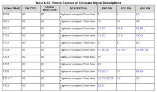

CC2340R5: Why Timer2 without compare0 pin?
Part Number: CC2340R5
Hi teams,
My customer ask why there is no T2C0 related pin?
Where to find the related description?
Thanks.

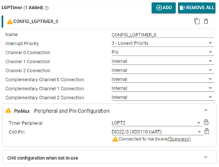

  • In syscfg, channel 0 of timer2 can be configurated. I am not sure I have the correct understand of the LGPTimer. Please kindly give some comments.
    Thanks.
  • Hello Connor Li,
    I hope you are doing well. I did try to replicate the issue on my end, and I did notice the same issue, you will need to define UART driver to use some other pin than Ch0 (DIO22). If you want some extra information on how to use LGPTimer then click on the "example" link, which will bring you to a page which details how to setup/use LGPTimer.

  • Hi Fager,
    Thanks for your support.
    But my customer still ask why there is no T2C0 related pin in the datasheet file? Maybe just a mistake or somewhere else have description?
    Thanks.
  • Hello Connor,
    I reached out to the HW team and they confirmed that there is a typo in the datasheet on this topic.
    DIO22_A9 should have T2C0 but it is listed as T2C0N instead.
    This will be corrected on the next release, thank you for bringing this up!
