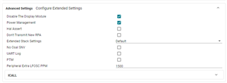

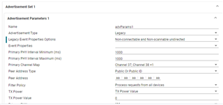

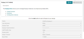

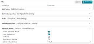

I am using CC2340-R5 launchpad and running Basic_BLE project in broadcaster mode only with limited advertising. My device advertises 3 packets at interval of 1000ms and disable the advertising, after that i turn on the advertisement again for after 30 sec using a timer clock as shown in the training module. but my power consumption during the non-transmission period is 3.8 mA (checked using power analyser). Below is the code (app_broadcaster.c) with some changes that i have made . i have disabled the LED GPIO's in sysconfig. still the current is high how do i reduce this current to uAmps or nAmps as stated in datasheet

BLEAppUtil_EventHandler_t broadcasterAdvHandler =
    .handlerType    = BLEAPPUTIL_GAP_ADV_TYPE,
    .pEventHandler  = Broadcaster_AdvEventHandler,
    .eventMask      = BLEAPPUTIL_ADV_START_AFTER_ENABLE |
                      BLEAPPUTIL_ADV_END_AFTER_DISABLE|
                      BLEAPPUTIL_ADV_END
//! Store handle needed for each advertise set
uint8 broadcasterAdvHandle_1;
const BLEAppUtil_AdvInit_t broadcasterInitAdvSet1 =
    /* Advertise data and length */
    .advDataLen        = sizeof(advData1),
    .advData           = advData1,
    /* Scan respond data and length */
    .scanRespDataLen   = 0,
    .scanRespData      = NULL,
    .advParam        = &advParams1
const BLEAppUtil_AdvStart_t broadcasterStartAdvSet1 =
  .enableOptions         =GAP_ADV_ENABLE_OPTIONS_USE_MAX_EVENTS,
  .durationOrMaxEvents   = 3
/*const BLEAppUtil_AdvStart_t broadcasterStartAdvSet1 =
  .enableOptions         = GAP_ADV_ENABLE_OPTIONS_USE_MAX,
  .durationOrMaxEvents   = 0

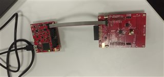

  • Hi Ankit,
    When you are taking your power measurements, are you connected to the XDS110?
    How are you powering the board?
    I ask because:
    1. When using the XDS110 connected via the socket to the CC2340R5 launchpad, the power measurements will be off. There are a couple reasons for this, but one that comes to mind is that the TX and RX lines have pulls on them, causing them to draw a lot of power.
    2. If you are connected via the XDS110 via the ARM cable (JTAG) then the power measurements should be better, but they still may be high.
    3. The best method is to power the board without connecting the XDS110 via the socket. All you need is the 3v3 line, ground, and optionally, the nRST line from the XDS110 to the launchpad.
    Nima Behmanesh
  • Do I need to change any jumper settings also, because I tried method 2 and 3 but energy trace window is showing zero current only. below are the screenshots
  • Hi Ankit,
    I see the setup now. Energy trace is through the XDS110 so there will be some more connections added. I'm not sure if you'll get accurate results this way though, so I'll need to ask some members of my team.
    I'll respond tomorrow EOD at the latest.
    Nima Behmanesh

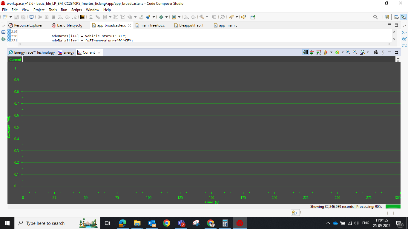

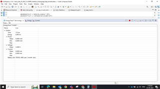

  • Hello Nima,
    i want to add one more info that, this issue is coming with my modified Basic BLE project (made changes in app broadcaster.c and disable display module in sysconfig), but i am able to see the current spikes in energy trace with original Basic BLE project.  Also when i checked the current consumption of my modified BLE project on Power analyzer available in our office lab i was able to see the current spikes on power analyzer properly but was not able to see it on energy trace. Below are the pictures of Power analyser, energy Trace and sysconfig settings.
  • Hi Ankit,
    Energy works over the 3v3 line, so you should be able to see it. I discussed with one of my colleagues yesterday and they said they may look into it to see if anything has changed.
    That's interesting that the modified example is not showing, though the out-of-box example is. It makes sense to me that you're seeing the right power spikes on the power analyzer. This seems to be something involving the XDS110. As far as I'm aware, removing the display shouldn't affect energy trace.
    I'll look into this further.
    Nima Behmanesh
  • Hello Nima,
    Did you get the solution for this?
  • Hi Ankit,
    I've tested this on my side with the same setup, and I'm able to see an energy trace.
    Are the wires swapped?
    Nima Behmanesh
