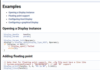

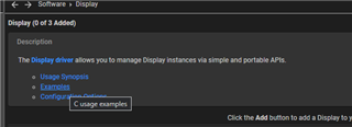

  • Hello Rajnishkumar Singh,
    In your SDK in syscfg go to the Display driver and click "examples" this will bring up documentation, and code snippets on how to properly use/configure the display driver! Use sprintf to a buffer to load up data before display_printf. Don't use Display_printf and UART2 at same time.
    Alex F
