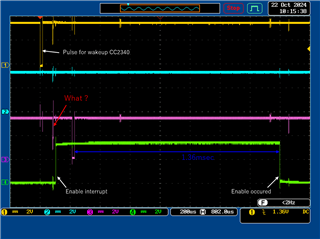

    However, there are two problems with the operation and one question.(see figure below)
     CH1:CC2340R5 wakeup and UART(CC2340R5 receive),  CH2:UART(CC2340R5 send), CH3:Dammy Data(LGPT CH1), CH4:For motion analysis
    Q1.The area indicated by the red arrow is Low for a short time. Why is this? (Under the condition that CC2340R5 is not connected, there is no output from the other IC.)
    Q2.The area indicated by the blue arrow takes 1.36 msec from the end of the dummy signal until the interrupt occurs. Why does it take so long? Is there any way to shorten the time? (I want to shorten the time for battery operation.)
    Tip: Waiting for dummy signal input is standby mode.
    Q3.Currently, I am getting the pulse length value with LGPTimerLPF3_getChCaptureVal() in the interrupt function, but the difference between LGPTimerLPF3_getNextChCaptureVal() and LGPTimerLPF3_getCounterWidth() ( respectively, which part of the time is measured value for each of the three functions?) Please let me know.

    Q1: Since that channel is data in from the external IC, I suppose its noise, or some sort of transient from the external IC.  You mention that the external IC is not outputting anything, are you taking this trace from the CC2340R5 or the external IC? From my understanding you are just monitoring the input pin for the external IC on the CC2340R5 without the IC connected?

    Q1. The oscilloscope image shows the state when the output port of another IC is connected.
    This is because the CC2340R5 will not proceed to the next operation unless it receives a legitimate dummy signal after an irregular Low pulse.
    However, as I mentioned before, the individual IC does not output an irregular Low pulse like in the image, so I suspect that the level might be changing on the CC2340R5 side when switching the port to the LGPT channel.
    Q2. It is the latter that you mentioned. I would like you to tell me which part of the image each function measures the time and outputs the values from.
    Thank you.
    Q1: I believe you are correct. When the CC2340R5 switches to the LGPT channel, there will be a bit of a current drop. I will do some digging myself and see if I can see something similar.
    Q3: The functions measure the period and pulse width in terms of counter ticks. You can read more about this under LGPTimerLPF3_CH_PULSE_WIDTH_MEASURE, in the LGPTimerLPF3_ChannelAction section of the API guide. I know there is a function to convert from counter ticks to milliseconds but cannot find it at the moment. I will provide more information Thursday (10/24).
