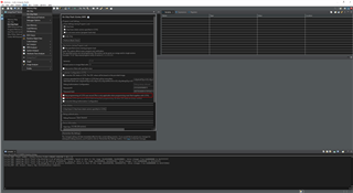

  • Hi Bun,
    Thank you for reply.
    We use uniflash 8.8.0.4946, but we would use Segger suite for flashing and debugging as stated in the thread on top.
    Using JFlashLite we can flash but then the application does not run, I guess because of CCFG records.
    Anyway I had a gowith uniflash and jlink and it fail to flash, below you can find an image that shows the failure reason.
    Thank you

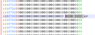

  • Hi Luca,
    I apologize for the delayed response, but here are my findings
    1. After digging through the hex file provided, I found that these CRC addresses below are all zeros when there should be some value there if you are planning to use a J-link as it does not automatically program the correct values. Please re-check your post build steps with CRC tool as it should re-write the  correct values in these addresses.
    • 0x4E02000C
    • 0x4E02074C
    • 0x4E0207FC
    2. Regarding your latest reply, this is expected as J-links do not automatically program the correct CRC values and when the software cross-checks the CRC value against its calculated value, based the hex data, it will not match which prevents flashing or executing.
