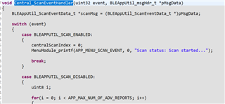

    1. Central_start() Function is called & all the events are registered properly but not getting any printf messages described in the Central_ScanEventHandler(). as per example once central app is active it should start the scanning operation as per the code but I never get my debug pointer stops inside this eventhandler.
    Ideally if I am using the same code with one with central & other with peripheral role should connect automatically. Do I need to register any other event to make Central_ScanEventHandler() more affective.
    Regarding the prints, are you connected through UART using a baud rate of 115200? The device will not start scanning automatically by default the project will scan when instructed to do so from the 2-Button menu. You are able to change the logic such that it does start scanning instantly with not input required. You should be able to modify the code such that a scan occurs and the device connects to the peripheral by identifying the device through the advertising data.
