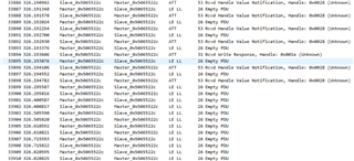

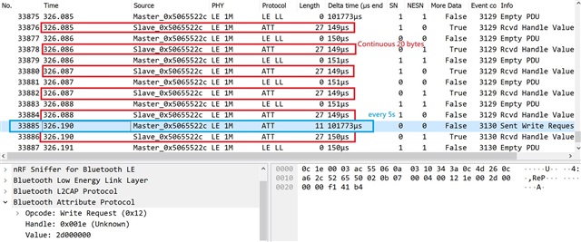

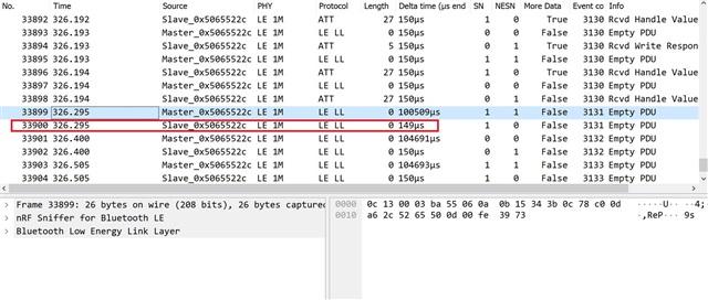

  • Have used the BLE sniffer tool to compare those captured data on both Android and iPhone cases. Seems I cannot see the differences between them.
    Continuously 20+7 bytes are sending from Slave and periodically 4+7 bytes are sending from Master for every 5 seconds.
    Picture1. Android case
    Picture2. iPhone case, writing 4+7 bytes for every 5 second without reading from Slave.
    Picture3. iPhone case, writing 4+7 bytes for every 5 seconds with reading from Slave.
    Please advise if any clues for me to further check. Thanks.

    Thanks for providing the links again. I am able to download the logs. Could you please help me understand where the issue is. According to what we discussed, when the device reconnects it is not able to transmit/receive data. However I am not able to see that happening, could you please point it out in the logs? For instance, I see the peripheral is sending some notifications up to a point and then it just sends empty packets, is this the case you are referring to?
    BR,
    David.
  • Hi David,
    Good and thanks for reviewing again.
    The device connects once started at time 0.000 and then it keeps sending 20 bytes to master (app) continuously . At master (app) side, it keeps sending back a 4 bytes packet for every 5 seconds to the device. It supposed to be that this connection and data communication operation will keep running without end. But in the ios case, after time 326.295 second the device stopped sending 20 bytes to master which is not expected. In my device program I set a test toggle pin keep running inside the main loop to let me know the main program is running normally. After the UNKNOWN issue happened, the test pin no longer toggle any more, so I think the device program is running out of control after time 326.295.
  • Hello Jeff,
    Thanks for the extra info. I see that the device does not crash, it just basically starts sending empty packets to keep the communication alive. What triggers the data transmission (notifications) - is the data coming from a sensor for instance?
