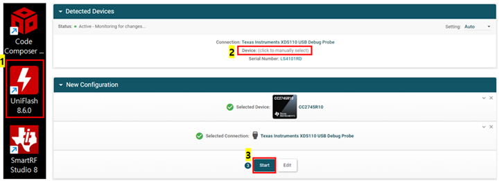

Set equal to manual. Using LP-XDS110 and CC2745R10-Q1 EVB.
2. Debugger setup
Using UniFlash8.6.0. Select CC2754R10 and Start.

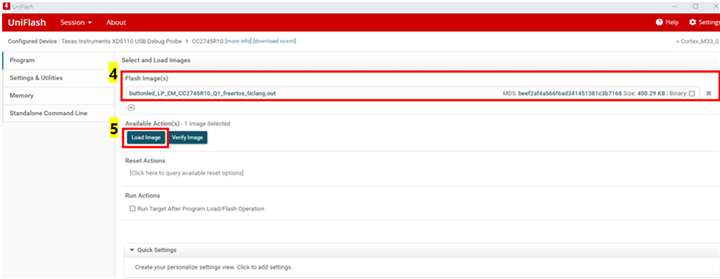

3. Firmware flash
Browse my firmware(buttonled_LP_EM_CC2745R10_Q1_freertos_ticlang.out) and Loag Image.

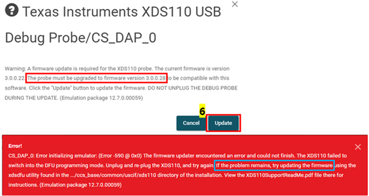

4. Debugger firmware update issue
Than i got a warning, i tried firmware update but that was failed.
My download debugger, LP-XDS110's firmware version is 3.0.0.22. Do I have to update the firmware version 3.0.0.28?

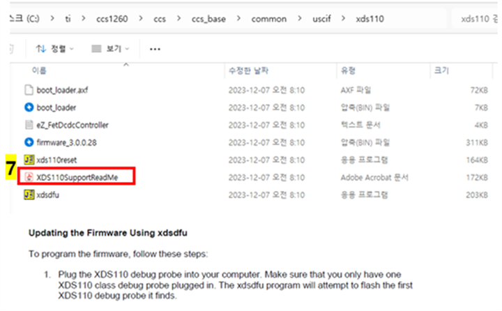

I tried version up to 3.0.0.28, referring to the XDS110SupportReadMe.pdf file.
5. Debugger firmware version update
There was 3.0.0.28 version of debugger firmware in the path where the XDS110SupportReadMe.pdf file was located.

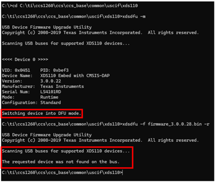

And the entry to DFU mode was successful by referring to the firmware update topic in the document.
However, when entering DFU mode, LP-XDS110 is disconnected and firmware update does not proceed.
The document says that when entering DFU mode, it needs time to re-recognize the debugger on the PC, but it does not connect again.

    It looks that the XDS110 was bricked in the process. However, when using CCS does this issue still occur? Additionally, were the device support packages installed on uniflash prior to flashing the device?
