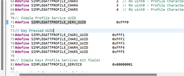

I have a CC2340 Launchpad board and am using it as a peripheral. I would like to add a custom service with the UUID 6e400001-b5a3-f393-e0a9-e50e24dcca9e, which currently allows modification of only 2 bytes of data. My goal is to modify it so that I can change all 16 bytes of data in the service UUID, as well as in the custom characteristic UUID.
I have attached a screenshot for reference.
Here only we can change 2 byte of data but i want to change 16 byte service id.
 we want to changes on marked area
Code Composer Studio Version: 12.7.1
SDK:simplelink_lowpower_f3_sdk_8_10_00_23_eng
Could someone please guide me on where I need to make changes in my code to implement this?

  • Hello Ratan,
    Could you please confirm if this is an automotive application (are you using the CC2340R5-Q1 device version)?
    What I do to modify my custom 128 characteristic UUID is something like this:
    //Base for 128-bit UUID: modify this as needed
    #define XXX_BASE_UUID_128( uuid )  0x11, 0x11, 0x11, 0xF6, 0x01, 0xAF, 0x7D, 0xBC, \
                                      0x05, 0x4F, 0x21, 0x5A, LO_UINT16( uuid ), HI_UINT16( uuid ), 0x5E, 0xAB
    // GATT Profile Service UUI
    static const uint8 xxxProfileServUUID[ATT_UUID_SIZE] =
     XXX_BASE_UUID_128(MY_UUID)
    BR,
    David.
