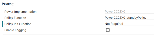

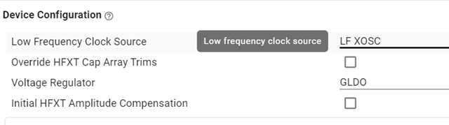

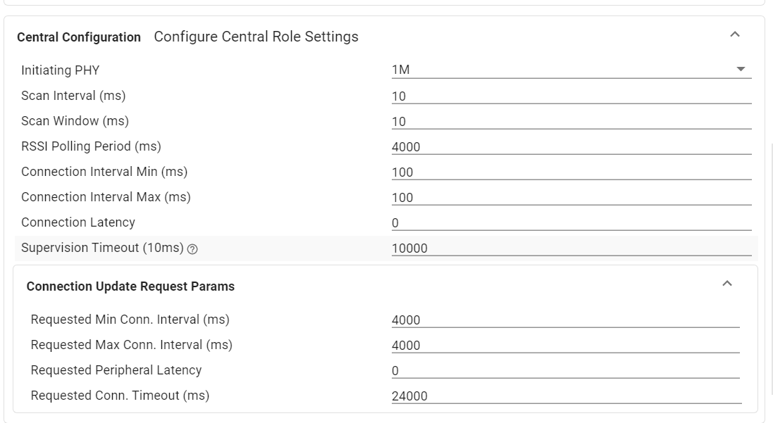

sysconf:
Enabled Peripheral + Central roles.

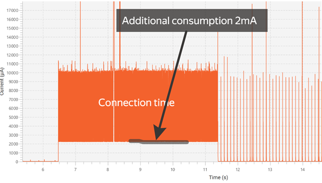

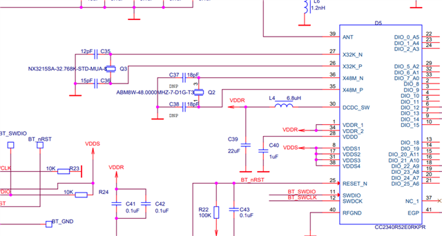

I connect the device to the Central.
During the connection process, I observe additional energy consumption of up to 2.2 mA.
The CC2340 should be in a passive state and only the RF channel should work.
Tell me, should the microcontroller go into sleep state? If so, what should be done for this?
