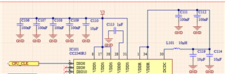

I am having some problems with my design using CC2340R52E0RKPR.
My design schematics are very close to the demoboard LP-EM-CC2340R5 schematics. Here is a picture of my design V3 power and DCDC schematics:

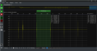

With an amp meter on my V3, in all cc2340R5 mode, I can see strange current peaks of 8 to 10 mA for about 1ms. These peaks have a period of 475ms. See the picture below :
In my understanding it is caused by the two inductors of the DCDC charge, C119 and C114. When I remove one, the 475ms period decrease. Is it a normal operation of the CC2340R5?
Because these peaks increase my average consumption and I would like to make them disappear or decrease. What is the cause and what should I do? Do I need to adjust the DCDC components?

  • Hi Bun,
    Thanks for the answer. The device is in Standby when I am running this test but i can see same peaks every 475ms in every state of the device.
    It's not advertising every 475ms , i verified it with a spectrum analyser.
    My application works with a small battery and need to be low consumption. The picture below shows the current draw zoomed, the left peak is the 10 mA peak every 475ms.
    Titouan
  • Hi Titouan,
    If the device is in standby and no BLE events are happening, then these are recharge pulses which are inherent to DCDC. You can remove one of the 10uF capacitors as our reference design only requires 1 and see if you are ok with the performance.
    If you want to remove both 10uF, expect higher DCDC ripple currents and more frequency recharge pulses. I am expecting more overall current draw here.
    Bun
