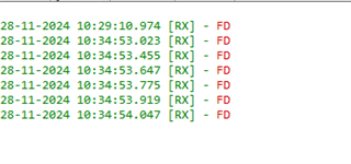

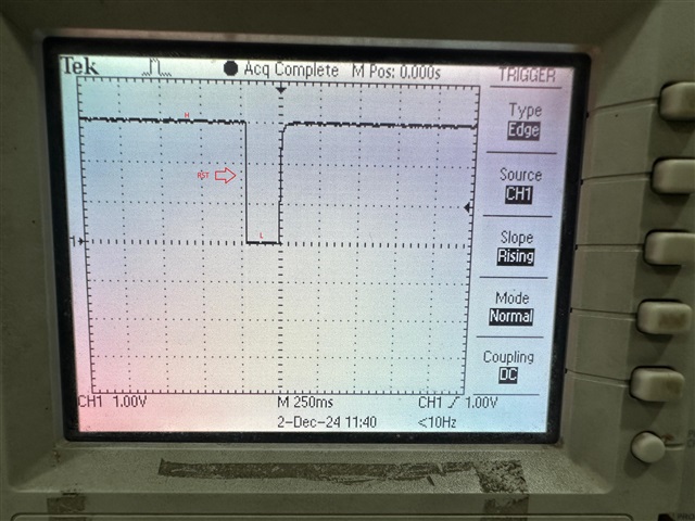

  • Hi clement,
    We have tried capturing TX line using DSO(Digital storage Oscilloscope) and we found after reset pin is becoming high then transmitting 0xFD / 0xFC then with x delay transmitting actual payload. For you reference attached image below.
    For your input we have tried configuring serialIoCfgIndex == 0 we are getting 0xFC and serialIoCfgIndex == 1 getting 0xFD
    But where as in serialIoCfgIndex == 2 we are not getting any additional bytes on UART.
    We have tried one more by changing the pin configuration open drain with internal pull-up and hardware pull-up also still we are getting additional byte on UART.

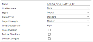

  • Hi clement,
    Is there a difference on the hardware design for the pins DIO6/DIO20 and DIO13?
    In our custom module we brought out UART TX has DIO 13 and UART RX has DIO 12.
    How the pins mentioned are configured before the reset occurs?
    Here I have attached an image of TX GPIO configuration and we are not changing any configurations on runtime and before reset.
    Vignesh.

  • Hi Clement,
    Attached are the images captured for the RST and TX signals.
    Thank you for providing. This confirms the proximity of the unexpected 0xFD and of the completion of the reset. I believe you have your root cause here.
    Workaround is to ensure your discard data received before the device is done booting.

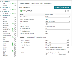

    Without initializing the UART as a peripheral, the 0xFD data is received during the boot process when UART2 is configured with TX and RX pins as serialIoCfgIndex == 1, and the display TI driver is disabled.
    Here I have attached an Basic_Ble_example project configured above UART2 pins.
    BASIC_BLE_EXAMPLE.rar
    Please can you test this project and let us know what changes required to be done for excluding the 0xFD printing on UART.

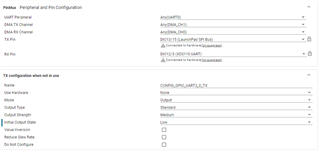

    This behavior is caused by the UART pin being pulled up after boot.
    One option for you is to actually keep the pin low, this way the noise on the pin will not be seen as a proper UART message and will be discarded.
    I hope this will help,
  • Hi clement,
    I have kept the UART TX pin configuration Initial Output State as low and while resetting  the module even though we are receiving 0xFD data on TX.
    thanks,
    Vignesh.
    I am not sure I understand your message - do you mean the problem is still there? Can you share the trace you obtain?

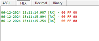

  • Hi clement,
    Yes, we are receiving( 0x00 0xFF 0x00 ) message on UART upon Reset.
    Can you let us know what kind of trace is required .
    Thanks.
    Thank you for sharing.
    This again confirms the issue is basically caused by the voltage level on the pin, and absolutely not by a UART transmission.

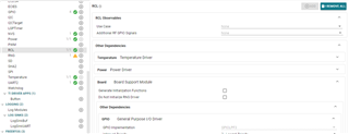

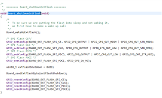

  • Hi clement,
    Where in Board_init(); function by default Board_shutDownExtFlash(); function is initialized. After disabling the Board_shutDownExtFlash(); function while resetting  the module  we are not receiving 0xFD data.
    To Disable the Board_shutDownExtFlash(); function made changes in syscfg.
    With above changes the issue has resolved.
