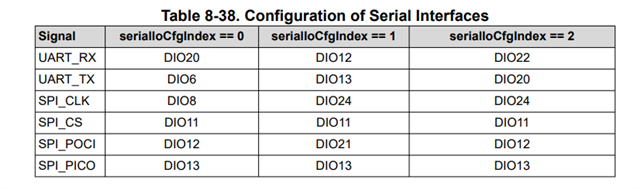

  • Hello
    Thank you for your response and guidance.
    I have successfully configured the system as per your recommendations and can now update the firmware over UART using the Linux SBL tool. However, I encountered an issue with the first-time firmware update process.
    Before utilizing the SBL to update the firmware, I need to program the OAD application along with the MCU Boot and Persistent applications using Uni-Flash. This allows the Serial ROM bootloader to be invoked via the configured pin, as previously set up in the MCU Boot project.
    Unfortunately, I am unable to invoke the bootloader on a blank device. Could you kindly provide guidance on how to perform the initial firmware update using the Serial ROM bootloader over UART?
    For reference, the device I am working with is the CC2340R52NORGER QFN24 (4x4, 512KB Flash).
    Looking forward to your advice.
    Blank devices will always boot in the serial bootloader mode, using the default bootloader configuration.
    The table below (taken from the device TRM, section 8.5.1.2 - https://www.ti.com/lit/pdf/swcu193) presents the default configuration for the device. For QFN24 package, the default configuration is serialIoCfgIndex = 0.
    I hope this will help,
    I have only DIO12, DIO20, DIO22 and DIO13 exposed in my custom PCB for the UART. I don't have access for DIO6. Please specify if there is any command or way to change the serialloCfgIndex 0 to 1 while updating the firmware for first time using SBL.
    Or if there any other way to use SBL for DFU update for the blank module using UART.
    Best Regards.
    Without access to DIO6, you won't be able to flash a blank 4x4 QFN CC2340R through its serial bootloader.
    If the SWD pins are available, you could consider using these to flash the device the first time.
