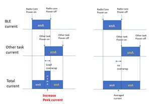

They want to run their application software while the radio core is not booted up for the maximum battery use.
Are there a way to trigger a callback when the RF driver starts and stops the RF Core?
Can you please tell a function to register a callback?
