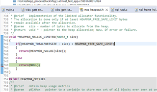

I have been develop modified host_test by cofigured GAP_BOND_MGR.
Role is peripheral.
If GAP_BOND_MGR is enabled, Our Host MCU can not receive the following event for CCCD of Notification or Indication.
[142] : <Rx> - 06:41:39.020
-Type           : 0x04 (Event)
-EventCode      : 0x00FF (HCI_LE_ExtEvent)
-Data Length    : 0x0A (10) bytes(s)
 Event          : 0x0580 (1408) (GATT_ClientCharCfgUpdated)
 Status         : 0x00 (0) (SUCCESS)
 ConnHandle     : 0x0000 (0)
 PduLen         : 0x04 (4)
 AttrHandle     : 0x000F (15)
 Value          : 0x02 (2)
Dump(Rx):
0000:04 FF 0A 80 05 00 00 00 04 0F 00 02 00          .............
If GAP_BOND_MGR is disabled, no problem,  Host MCU can receive it.
I 'd like to use pairing sequence (Bond manager) and  ATT Notification/Indication sequence.
I can not use both functions together. Why?
SDK version is simplelink_cc13xx_cc26xx_sdk_7_41_00_17.

  • Hello.
    When CCCD is reception, it can not allocate momory.
    Please find image below.  Source cod is near with original host_test.
    Because the below procecing is executed,  GATT_ClientCharCfgUpdated event is not sent.
    heap size is 10280 by AUTOHEAPSIZE because it is set  HEAPMGR_SIZE=0x0.
    heap free size is less than HEAPMGR_FREE_SAFE_LIMIT (550). Why?
    Okazaki
  • Hi Okazaki,
    This is a good catch, thank you for noticing.
    I believe we should get you to verify the actual heap available. When you hit the breakpoint shown in the screenshot, could you please open the ROV and check the remaining heap? The debugging guide provide some guidance to do the same: https://software-dl.ti.com/simplelink/esd/simplelink_cc13xx_cc26xx_sdk/7.40.00.77/exports/docs/ble5stack/ble_user_guide/html/ble-stack-5.x-guide/debugging-index.html#runtime-object-view-rov
    After this - assuming you actually get a heap shortage - we will have to work in order to find RAM savings, possibly by reducing the stack of certain tasks (options can be identified using the ROV and looking in the "task" view the task-peak usage).

    A memory allocation seems to be failing in your example, and I suggested to further look into it.
    Please let me know your progress.
