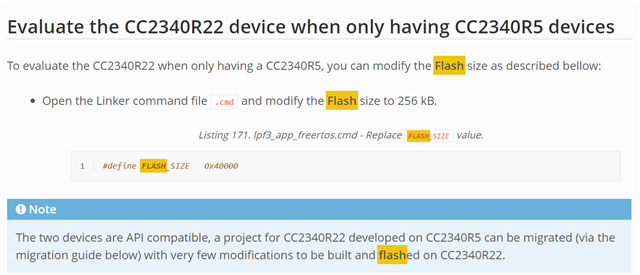

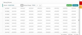

    I hope you are doing well. First lets double check that the device is functioning properly, can you open UniFlash and attempt to read the device memory (this should confirm that the device and debugger are ok).
    For modifying the flash we can leverage some of our migration examples (as we also modify the flash) from the SDK documentation:
    CC2340R5 to CC2340R22 Porting Guide — SimpleLinkTm Low Power F3 SDK BLE5-Stack User's Guide 3.03.02.00 documentation

    The device works and shows no errors after restoring the 'FLASH_BASE' setting to 0x00000000 and updating the code in debug mode.
    Once I changed the FLASH_BASE to 0x00010000 and updated the code, the errors appeared again.
    This leads me to believe the issue is related to the FLASH_BASE setting, as the device itself is functioning properly.
    Do you have any further information or suggestions to help me resolve this issue?

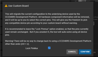

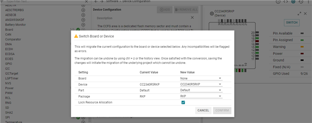

    In your Syscfg did you set your board to a custom board? One thought is that syscfg may still want to use the original flash base rather than the new one.
    -Did you already follow the flash modification in the porting guide? (https://dev.ti.com/tirex/explore/content/simplelink_lowpower_f3_sdk_8_20_00_119/docs/ble5stack/ble_user_guide/html/ble-stack-5.x-guide/porting-guides/cc2340r5_to_cc2340r22.html?highlight=flash#migration-guide
    Alex F
  • Hi Alex,
    I made the modifications in the .cmd file as shown earlier and set my board to a custom board, but it still didn't work.

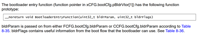

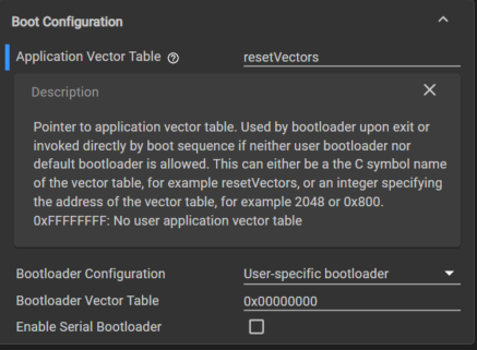

    1. Did you update the Bootloader Vector Table in the CCFG?
    It very well could be that ROM is jumping to wrong place because the vector table wasn't updated. You can find these settings in sysconfig Device Configuration --> Boot Configuration.
    2. Please read section 8.4.3 and 8.4.1 in the Technical reference manual for the CC2340. These two sections outline specific requirements for creating a custom bootloader.
    For instance, the bootloader entry function has a specific function prototype:
    Additionally, per point 1:
    Please let me know if you have more questions.
