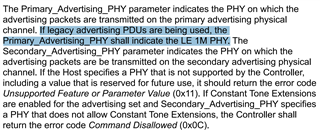

Hi as per my understanding CC2340R52 will support BLE v5.3 and hence it has to support Primary PHY data rate of 2Mbps but in sysconfig tool it is showing only 1Mbps option why ?
What does the secondary PHY means this shows 2Mbps option.
Let me put my need [ We need BLE v5.x-based advertisement packet to be sent with PHY data rate of 2Mbps] , please let us know what settings need to be done in sysconfig file of Basic BLE example application to achieve this
    Legacy advertisements only support 1M PHY for the primary advertising PHY, and do not support a secondary advertising PHY. Please see Bluetooth Core Specification Version 5.3, Vol 3, Part F Section 7.8.53.
    Since Legacy Advertising does not include parameters beginning with secondary other PHYs are not allowed.
