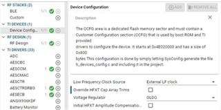

Does the CC2340 have a default internal load cap value? Also, are the "trims" that you can override within SysConfig offsets from this default value? We have already found the chart on other E2E posts which gives approximate values from pre-release silicon to understand these trim values as well but want to ensure they are being used correctly.

    I will have to defer to the HW Team for default internal load cap values.  I believe the SysConfig HFXT Cap Array Trims overrides (adds CKMDSetInitialCapTrim / CKMDSetTargetCapTrim to ti_drivers_config.c Board_init) should be the same as the Smart RF Studio 8 Q1/Q2 values, but once more will get other experts to weigh in on this.

  • Hi Luke,
    When the HFXT cap array tuning is disabled, the default cap array values that was programmed at production will be used. I believe that at the moment it is 35.
    When the cap array tuning it is set to use board settings, it is suppose to use cap array values for our LaunchPad. However, this is not implemented for CC2340 yet. So if this option is selected, it will be the same as having the disabled option. It will just use the default FCFG settings.
    When the cap array is set to zero, the total effective capacitance will be around 3.7pF for our LaunchPad.
    If the customer wants to remove the frequency offset, they should have the cap array tuning enabled and change the cap array values to whatever gives the minimum frequency offset on their board.
