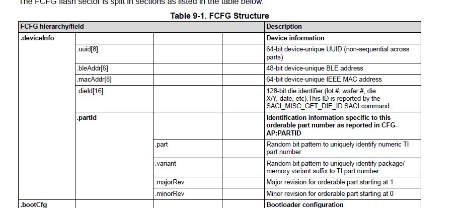

My customer wants to know which information is the unique number for each die.
.uuid[8[, .bleAddr[6], .macAddr[8], .dieId[16].

Thanks for your reply. I understood all of these number is unique.
My customer wants to use this number as their board identifier before assigning and writing the Serial number in the Flash ROM.

I see. To your initial question, the dieId is the unique number for each die.

Our customer wants to know the range of "Unique" with ..uuid[8[, .dieId[16].
Are these Identifier is unique across the all TI device or just only unique in CC2340R5 devices?

I believe it is unique across all devices, for instance, the dieId one includes date as part of the identifier. Also, the bleAddr is unique among devices as it is a BLE Public Address.
