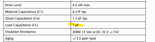

How should I size my 32.768KHz oscillator caps? Can't find a portion in the datasheet. Couldn't get a clear answer from this guy either: https://www.ti.com/lit/an/swra495k/swra495k.pdf
Here's how we do it on the EVM: I notice one cap is 12pF and one is 15pF. Curious if there's a reason they're different and if I should do the same. For reference, I'm using this external crystal: (should fall in the LEXT datasheet spec)
Thanks!~
    The total load capacitance is what matters, so the capacitors C81 and C91 were tuned to a more exact value of total capacitance (hence why they are not equal values).

    I am confused by the datasheet spec. I see the y1 on BOM is ~7pF:
    Wouldn't the 12pf / 15pf be too much? Thanks
    There are 2 factors to consider:
    • The load capacitors are actually in series when considering the total crystal oscillator circuit; for an explanation of this see Section 2.3 and Section 3.3 of SWRA495 (Crystal Oscillator and Crystal Selection for the CC26xx and CC13xx Family of Wireless MCUs): www.ti.com/lit/swra495
    • The PCB parastics must also be taken into account.
