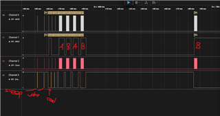

- SPI transfers are successful and work (healthy transactions, what I expect, data is read back successfully too)

- Logging, my code is essentially, where the last log is immediately after spi_transfer:
log (start SPI transfer) //this prints to log
spi_transfer(stuff) //SPI trasnfer completes via Saleae reading
log (end SPI transfer) //never prints

  • Implemented your recommendations, code looks healthy. Transfer wise, ~5 SPI transfers, long ones where I attempt to read back an entire page of flash. 256 bytes + 4 = 260 total. All 260 transfer the first 4x, and all 260 the final problem child.
    A's are identical, B's are identical

    ==== Often, this is where log ends ====
    COM3 |  0.034064000 | LogMod_LogModule0 | Log_DEBUG   | ../source/SPILPF3DMA.c:417                    | Loop iteration 0
    COM3 |  0.034128000 | LogMod_LogModule0 | Log_DEBUG   | ../source/SPILPF3DMA.c:433                    | Using primary DMA channel
    COM3 |  0.034160000 | LogMod_LogModule0 | Log_DEBUG   | ../source/SPILPF3DMA.c:450                    | TX channel idle & no queue: disabling DMA TX
    ==== Log never goes beyond here ====
