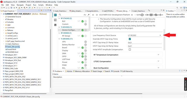

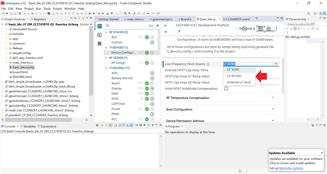

Upon investigation, we realized that our board does not include an external 32.768 kHz crystal oscillator, although the firmware was configured to use the LF XOSC. After updating the configuration to use the internal LF RCOSC instead, the current draw significantly improved, and the system successfully entered low-power mode.

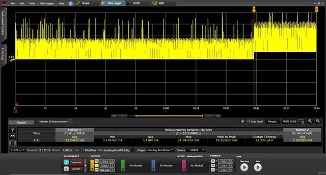

However, we are now encountering a new issue: after approximately one minute of operation, the sleep current suddenly increases significantly. We have not been able to identify the root cause of this behavior.

We have attached the power analyzer waveform for your reference.
Could you please help us understand what might be causing this sudden rise in sleep current ?
above image you can see after some time how it has increased
you can see initially sleep current of our device was 146.339uA.
After 1 minute sleep current has been increased to 3.18mA.
