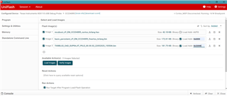

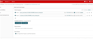

  • It's possible that you have flashed the persistent app and the firmware at the wrong address. Could you send a screenshot of your uniflash before flashing, and could you try swapping the address you use for the persistent app and for the firmware ?
  • Hi, in your screenshot, you are not flashing your firmware. Your uniflash should look like this (screenshot from the SLA about MCUboot).
    You should make sure that the MCUboot binary is the first element, as it should be flashed at address 0x0.
    I highly recommend to read through this SLA and to follow the on-chip examples in a new workspace to familiarize yourself with MCUboot.

  • Hi
    I even tried that way but still it is only loading to persistent

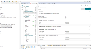

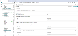

    Could you show me the content of your Sysconfig for MCUboot ? Does it look something similar to this ?
    Could you also try the exact same setup as your last screenshot, but using the hexfile for MCUboot on-chip instead of the one you built yourself, and tell me if it works, in order to know if the problem comes from the MCUboot binary ?
    Kind regards,
    Maxence
    I dont see that option in sysconfig

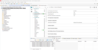

    It surprises me that you don't have the MCUboot option. Maybe your version of the SDK or SysConfig is older than mine. Could you go to the properties of your project and then to General > Products, and tell me which version of the SDK you are using, and which version of SysConfig are you using ?
    Kind regards,
    Maxence
  • Hi
    Here you go!
    Vaibhav
  • Hi !
    Your SDK and SysConfig versions are 1 year old, and I suspect that the MCUboot setting in sysconfig was added recently. I would try to update the SDK by downloading it here LINK, and then create a new workspace, import the MCUboot project from the new SDK, remove the led blinking instruction, and see if it works.

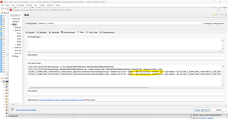

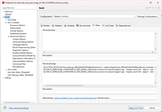

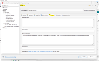

    Another possibility is that your firmware image is not properly signed which causes the verification of the firmware image to fail. There could be many reasons to that , have you changed the private key used for signing your firmware ?
    Could you show me the post-build steps of your firmware ? You can find them by right clicking on your project in CCS, then going to Properties, Build and finally Steps. This is what it will look like :
    As for sending your firmware, you can send me a friend request on this forum and send me the file through a private message. But please continue to talk about the issue here and not in private messages, as your issue could help others Smile

  • Hi Maxence,
    Below i have attached snap of both persistent.bin and app.bin . If i am understanding correctly at address 0xA0 we have 0xFF on both file.
    Below is screenshot of post-build steps
    Vaibhav
  • Hi, sorry I was wrong and the right address is for the image version is 0x14. The image version for the persistent app is 0.1.0 and the version for the firmware image is 1.0 so that's not the problem.
    The second screenshot you send are the build steps but for the MCUboot project, but I need the post build steps of your firmware instead Sweat smile

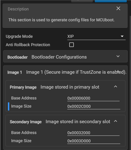

  • Hi !
    I have found the solution to the MCUboot not booting into your firmware problem. By default, your image is linked in a way to have 0x32000 as its base address. However, in MCUboot you specify the secondary image address to be 0x43000 instead of 0x32000. While MCUboot will not have a problem booting into this image, the firmware itself will not work since it is placed incorrectly.
    The solution in your case is to change the MCUboot SysConfig settings to these, and to flash using UniFlash with these offsets :
    With those settings I was able to boot into your image.
