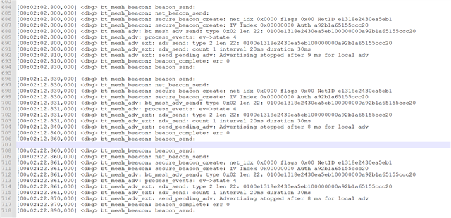

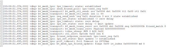

    Here is the log we captured. It shows that after the LPN and FN establish a connection, the node continues to send beacons.
    Additionally, the log indicates that the LPN’s receive window is quite long, which is a major reason for the higher current consumption.
    We hope this information helps your analysis.
    Thank you!
    Thanks for the logs, this is valuable information that the team responsible for this will use to try to fix your issue.
