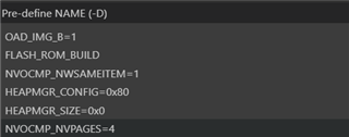

To work around this limitation, I increased the NV storage size to 0x8000 and set NVOCMP_NVPAGES to 4. The intention is to allocate Customer's NV IDs to NV pages 2 or 3, allowing for erasure of these entries by erasing an entire page at once.

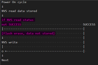

    To work around the NVS issue, I erased the flash and loaded the image via UniFlash, then performed an initial reset of the board. However, the flash read status and data appeared to be incorrect. A subsequent reset of the board the same incorrect results.

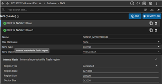

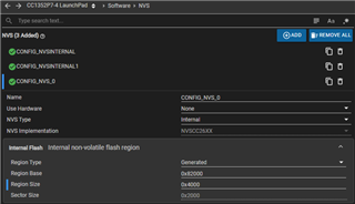

    Is it possible that your CONFIG_NVS_0 is overwritten by CONFIG_NVSINTERNAL or CONFIG_NVSINTERNAL ?
    Could you send me sysconfig screenshot of those configs ?
    Kind regards,
    Maxence
  • Hi Maxence,
    FYI

    After a power cycle, the system should verify the contents of the NVS. If the flash has been erased or the data was not previously stored, the read operation should not return a success status. A comparison should be made between the results of osal_snv_read and NVS_read to detect such conditions."
