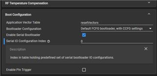

We are trying to enter bootloader mode, but the CC2340R52E0RGE is not responding to any commands.
In our module design, we have configured DIO12 and DIO13 as index 1 (corresponding to Boot and Reset), but we are not getting any response during the bootloader sequence, Why ?
  • Hello Rahul,
    Are you using a custom bootloader or the default bootloader?
    Following our syscfg you should have something like this:
    This is where you configured index from 0, to 1 correct? If so index 1 is being used which sets the RXD and TXD to DIO12 and DIO13; however, we also need to use the pinTriggerDio, which by default is 21.
    When you did you test you used the DIO21 to tell the device to enter into bootloader (after a reset)?

  • Hi Alex,
    My default TXD and RXD is DIO12 and DIO13. Will i be able to access the bootloader ?
  • Hello Rahul,
    The default index of the CC2340R52E0RGE is 0, which means DIO20 and DIO6 are used, if you set the index as 1 in syscfg the DIO's will change to DIO12 and DIO13. Assuming you use DIO21 to trigger and enter the bootloader you should be able to access the bootloader.
    *Note that syscfg also has settings to disable the bootloader, I assume you have allowed the bootloader to be entered via syscfg here.
