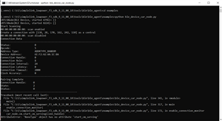

In the .py script we put the com number corresponding to the car_node and one key_node, in the terminal we have an error indicating
Also, we have tried the steps described in connection monitor, we got this error,
This error appears on the old sdk and it disapear when disabling the l2cap, and it gives then an other error.

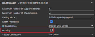

    Please set the l2cap_enabled variable to false. Additionally, I recommend disabling bonding on the Car Node example. This should allow you to run the ConnMonitor demo successfully. Could you also please document what the other fail case is so I can assist with that?
    In regards to the Connection Handover, you should be running it with 2 car nodes, and 1 key node device instead. From the screenshot you have provided, it looks like one serial port was successfully opened, and it was probably the one which was running the car node example. Please try with the suggested configuration and let us know the results.

  • Greetings,
    Could you please share which projects you are using to test the CM? It looks like the node that the python script is requesting to start monitoring, does not have the capability to start the connection monitoring. This could happen if you have an incorrect project flashed. This example should also be run with 2 Car Nodes, and 1 key node.

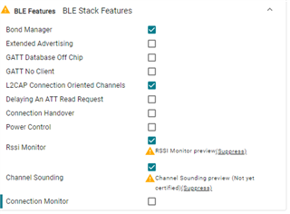

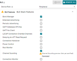

    But i'm reaching you because i still struggling with the connection monitor. I will cite here the detailed steps may be i have missed something or did it wrongly.
    So, let's break it up:

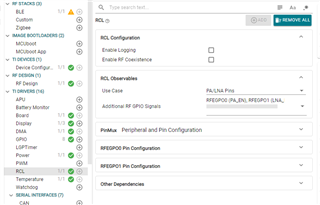

    1- for the key_node i loaded the project into ccs, and enable the PA/LNA, with no change in the ble_feature
    2-for the cmr_node, i loaded the car_node project, enable the PA/LNA pins, and enabling the RSSI
    3-for the car_node disbaling the connection_monitor, keeping the PA/LNA pin enabled
    --> After changing the com port, always getting this error
    So my concerns are if those steps are correct and for the RCL pins PA/LNA is it neccessary to connect them, if yes how to do that and which feature to use.
