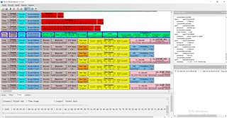

    Can you provide an Ellisys log of what's happening over the air?
    Where are you calling GAPBondMgr_Pair?
    Do you have any authenticated/encrypted characteristics that are being read before pairing/bonding?

    2. Sorry, I don't have Ellisys device but WCH BLE analyzer, is the WCH log OK for you?

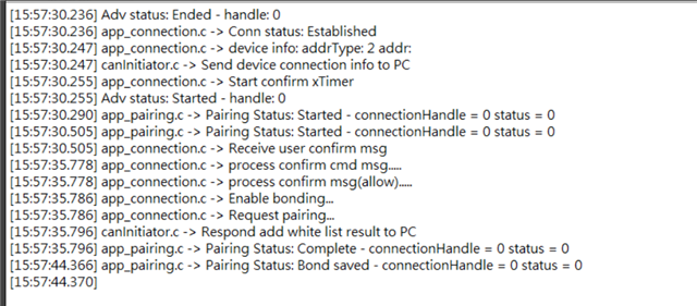

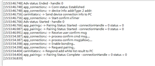

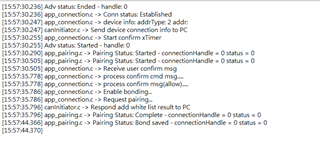

    In my current environment(with the bonding flag unchecked in syscfg), As I mentioned above when the phone initiate a connection, a pop-up window will appear on the mobile device asking for the PIN code:
    1. If enter the PIN code immediately, then have the CC27xx confirm the request and call "GAPBondMgr_Pair", it will fail to bond device
    2  If  have the CC27xx confirm the request and call "GAPBondMgr_Pair" before pairing timeout first, then enter the PIN code at phone side, the 2475 can bond device successfully(Pairing Status: Bond saved)
    Additionally, after the binding was successfully completed and saved, I attempted to call the below API to delete the binding record, but it failed and returned 0x34. Could you please inform me about which interfaces are available for the operation of deleting both the binding and whitelist records?

    Additionally, I would like to see the code in BLEAPPUTIL_LINK_ESTABLISHED_EVENT, because what I see from this log:
    Is that the pairing has started before the user confirm msg and after link establishment. This doesn't seem to match the order that you're expecting.

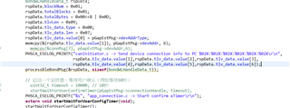

     1. I call CAN API(processBleBondMsg) to send msg to user in  BLEAPPUTIL_LINK_ESTABLISHED_EVENT:
    2.Call gapEnable_Bonding and gapBondMgr_ReqPair  in CAN task once receive the user's confirm msg
    As we know the current issue is that a pairing started immediately when the phone connected. would you please help to check and show how to do in syscfg to prevent starting the pairing immediately when the phone connected, so that I can requesting a pairing after user confirm and act as the flow you mention:
