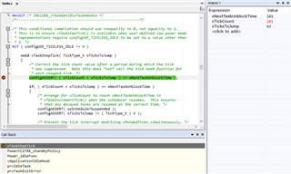

In the following environment,"xTickCount+xTicksToJump" has exceeded "xNextTaskUnblockTime" and is asserted.
\ti\simplelink_lowpower_f3_sdk_9_10_00_83\source\third_party\freertos\tasks.c(2581,10)
Call function: vTaskStepTick()

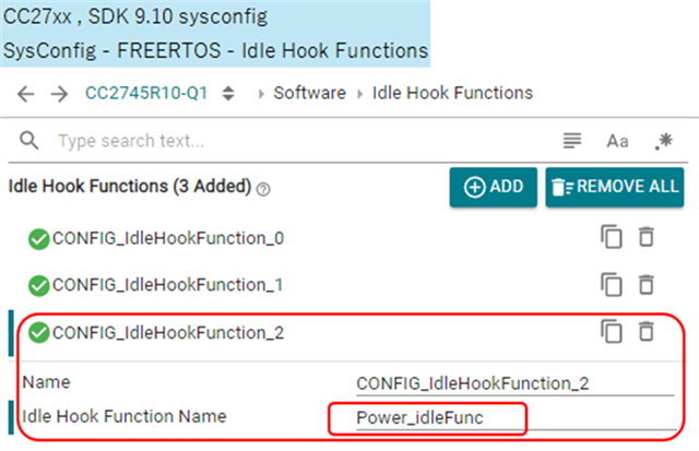

  • Additional question
    In our project, we set Power_idleFunc() as the FreeRTOS Idle Hook Functions in SysConfig.
    We found that the assert in question was occurring in the route of Power_idleFunc(), which is called directly from vApplicationIdleHook().
    If configUSE_TICKLESS_IDLE = 1, there is also a route of Power_idleFunc() called from vPortSuppressTicksAndSleep(),
    which means that Power_idleFunc() is called from two places in prvIdleTask(). Is this a problem?

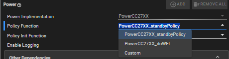

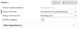

    If PowerCC27XX_standbyPolicy is set as the Power - Policy Function, shouldn't Power_idleFunc be set as the Idle Hook Function?
    The idle hook function is called before the power management hook function. So in your case, if you set the power management function as both an idle hook and in the power policy, you would be calling it during the idle function as well as after.
    Without testing, I wouldn't be able to say that this would cause a problem, but knowing the flow: Idle Hook -> Power Management Function, I'd say to avoid repeating the same power management function twice.
    Any power related functions (like a power policy) should go into the Power section of Sysconfig:
    That way you won't have any redundant function calls.
    Hope that helps!
