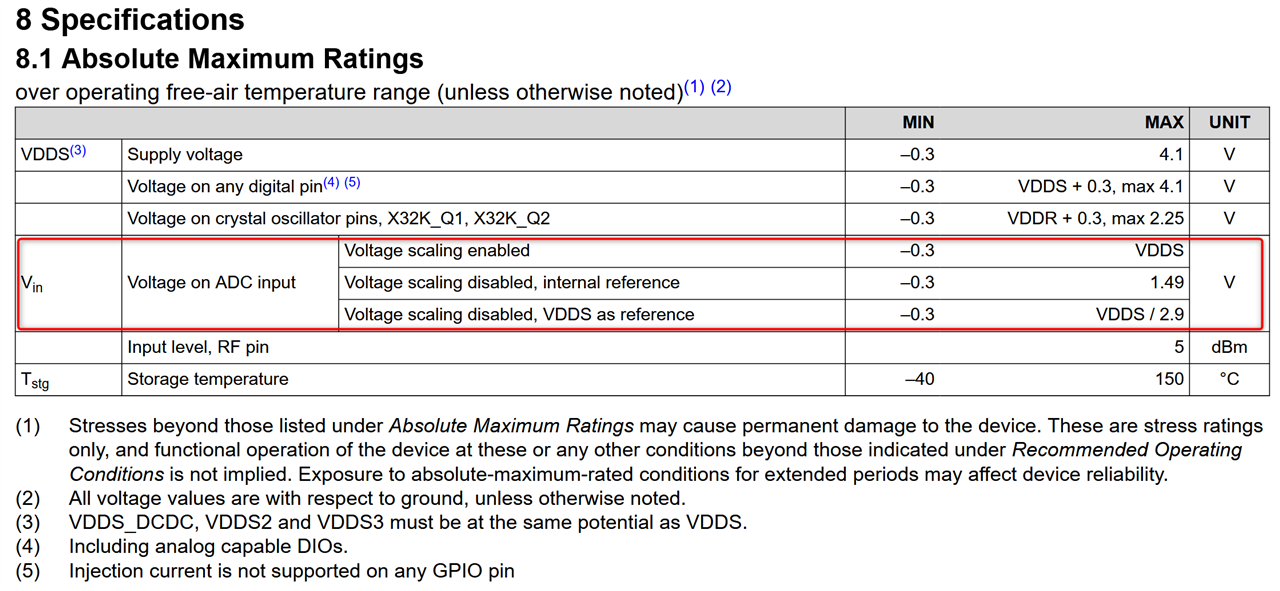

    As background, our system is operating under the following conditions:
    - VDDS = 2.5 V (±1%)
    - ADC input range = 0 to 2.5 V (since the "ADC Input Voltage Range" is specified as 0–VDDS)
    For the ADC configuration, we have selected:
    - Reference voltage = VDDS
    - Input voltage scaling = enabled
    Based on this, we would like to confirm the following points:
    Q1:
    We understand that the accuracy of the reference voltage (such as its offset and noise) has a direct impact on ADC precision.
    In terms of overall accuracy, which option would provide better performance: using VDDS or using the internal fixed reference voltage?
    Q2:
    When using the internal reference, we see that there are two available settings:
    - 4.3 V / input voltage scaling is enabled
    - 1.48 V /  input voltage scaling is disabled
    In these two cases, what is the corresponding ADC input full-scale voltage range?
    Q3:
    If we choose the 4.3 V internal reference with input scaling enabled, does it mean that the ADC's full-scale input range is 0–4.3 V, even though the actual maximum input voltage (due to VDDS limitation) is only up to 2.5 V?
    These may be basic questions, but your guidance would be greatly appreciated.
    We want to ensure proper understanding and safe operation of the device.
    Thank you very much in advance for your support.
    I would strongly recommend you to read section 19.4.2 of the Technical Reference Manual (TRM) which contains the detailed description of the ADC peripheral.
    Q1: as you can imagine, the internal reference voltage has the best accuracy and precision.
    Q2: the scaling will add some uncertainty to the ADC, as stated on the TRM section mentioned above and on the specifications shown in section 8.16 of the device datasheet. The input voltages are shown in section 8.1 of the device datasheet as well.
    Q3: as you mentioned and is shown in the screenshot above, the maximum input voltage to the device is VDDS.
