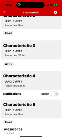

  3. Click "characteristic 5" and bond to device

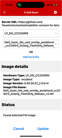

5.setting OAD as below

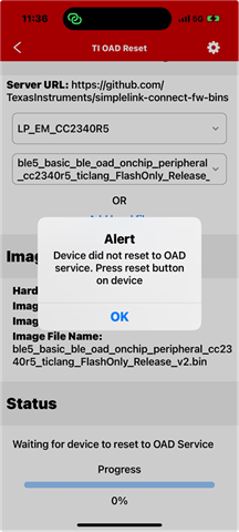

6. after clicking "Update", it would show below.

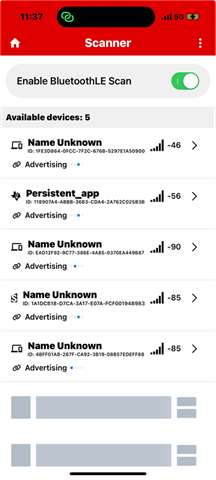

7. Reset the evm and scan the device. it only find  Persistent_app.

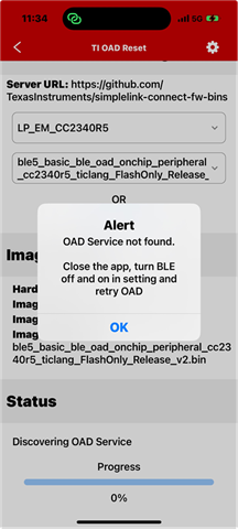

8.connect and try OAD. it shows error below.
9. after press the reset button, it shows same error as item 6.

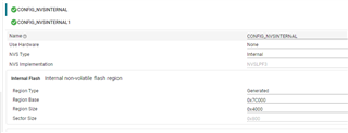

    nvs setting in basic_ble_oad_onchip_LP_EM_CC2340R5_freertos_ticlang

    I confirmed with the mobile app developers and they have verified that this is an iOS problem. It is related to how iOS handles the BLE cache information. As mentioned in the picture you attached to step 6, the solution is to restart BLE on the iOS side.

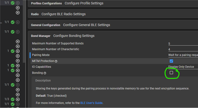

  • Hi Frank,
    I believe this has to do with how the iOS device handles caching. I have made a note of this in  the ticket filed for this issue.
    Jan
  • Jan,
    if customer doesn't really need to bonding the device, they just want to have passcode to limit the access from any central device.
    Is that ok to uncheck above or other suggestion?
    It works for OAD.
    BR,
    frank
  • Hi Frank,
    That should be enough to save the bonding process but retain the pairing procedure.
    Jan
