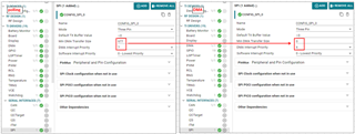

In the above environment, the SPI communication method was changed from polling to DMA.
(Changes(Sysconfig))
SERIAL INTERFACES -> SPI ->
Min DMA Transfer Size: 977 → 0
DMA Interrupt Priority: 7 → 6

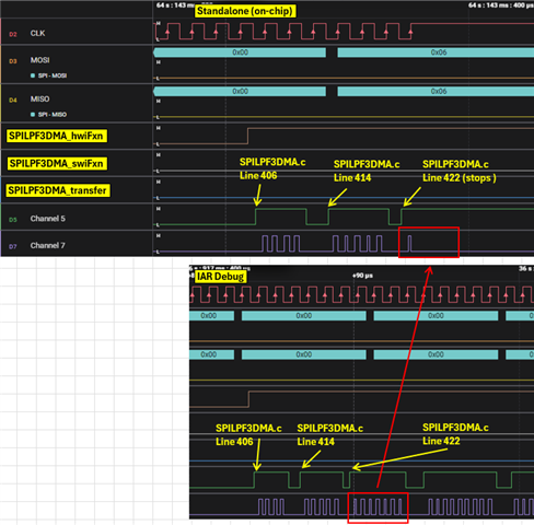

After making the above changes and debugging each,

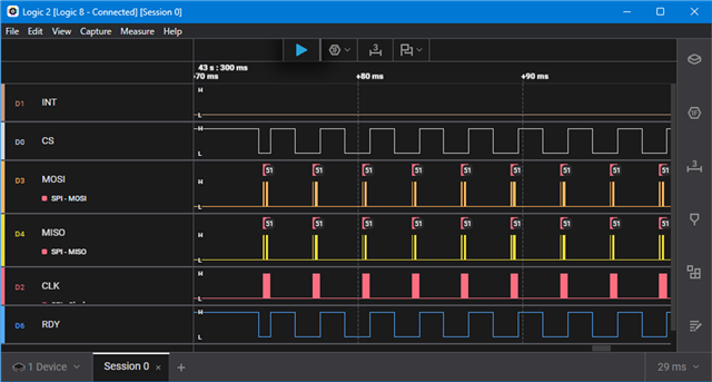

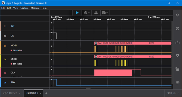

Before the change (polling): When trying to send 51 bytes of data, 51 bytes of data is sent. (Data transmission successful)
After the change (DMA): When trying to send 51 bytes of data, 35 bytes of data is sent. (Data transmission failed)
Why does this result?
Sho

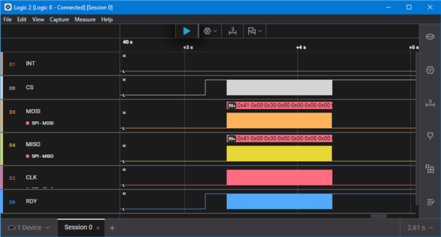

  • The above problem (35 bytes of data are sent) occurs when the board is operating alone (on-chip).
    When debugging with IAR, 51 bytes of data can be sent.

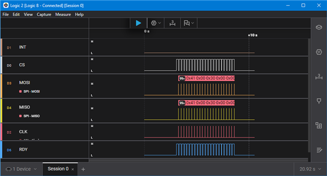

  • > The above problem (35 bytes of data are sent) occurs when the board is operating alone (on-chip).
    Regarding the above phenomenon,
    When sending 14 bytes, during debug execution: 14 bytes sent When board alone (on-chip) operation: no sending
    When sending 51 bytes, during debug execution: 51 bytes sent When board alone (on-chip) operation: 35 bytes sent
    When sending 99 bytes, during debug execution: 99 bytes sent When board alone (on-chip) operation: 83 bytes sent
    In each case, the length of the sent data is 16 bytes shorter, and the clock for 16 bytes is not running.

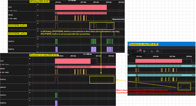

  • Hello, Tarek,
    Is the investigation progressing?
    If you know anything at all, please let me know.
    Compared to when debugging with IAR,
    when the board is running alone (on-chip),
    there is 16 bytes less data sent (the clock stops midway),
    so I think there is something suspicious about the initialization.

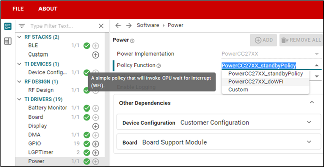

    M apologies for the delay! Could you attempt changing the power policy from standbyPolicy to doWFI? To do this:
    1- Go to the syscfg file inside your project
    2- Go to the Power section of the TI Drivers
    3- Change the power policy from standbyPolicy to doWFI
    This may not be a permanent fix, but will help us in further diagnosing this issue.
    Tarek D

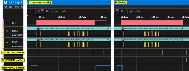

  • Hello, Tarek,
    The power policy has been changed from PowerCC27XX_standbyPolicy to PowerCC27XX_doWFI.
    The results were the same:
    IAR Debug : 51bytes
    Standalone (on-chip) : 35 bytes
    IAR Debug
    Please let me know if there is any additional information you would like.
    Sho

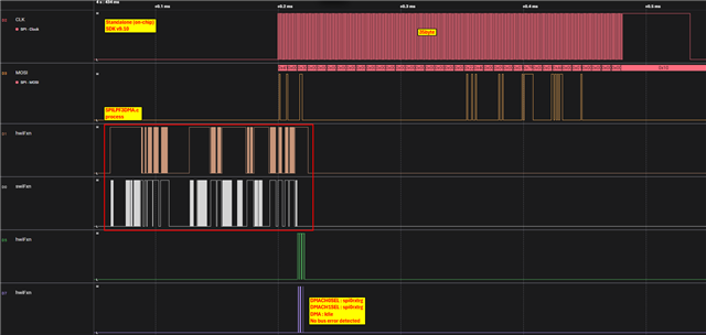

  • Hello Sho,
    Thank you for providing this info! This indeed is very strange behavior. As a test, could you test the out of box SPI examples found inside the SDK? Also, could you provide some more code snippets, so that we can further analyze what's going on?
    Tarek D

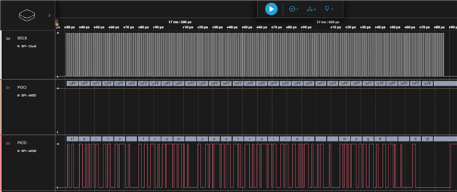

  • Hello Sho,
    I am using SimpleLink F3 SDK v9.11.00.18 with the spicontroller example on a LP-EM-CC2745R10-Q1 with IAR ARM v9.60.3 and am not observing the issue you are reporting.  Please note that the CC2745R10-Q1 was not fully supported in the SimpleLink F3 SDK until v8.40 according to the SDK Release Notes.  I am providing spicontroller.c and spicontroller.syscfg for your reference.  Please consider upgrading your SimpleLink F3 SDK and provide additional comments if my example does not adequately configured to demonstrate the issue

    ●Upgrade from SDK v8.30 to SDK v9.10
     I upgraded from SimpleLink Low Power F3 SDK v8.30.00.11_ea to SimpleLink Low Power F3 SDK v9.10.00.83.
     At the same time, I upgraded from IAR ARM v9.50.2 to IAR ARM v9.60.3.
     After that, I made the following changes in Sysconfig.
     The result was the same as before, changing from 51 to 35 bytes after changing to DMA.
     For reference, I am sending you the Sysconfig used with SDK v8.30 and SDK v9.10.
     (Are there any other items that need to be set in Sysconfig?
     Have there been any more setting items (SPI/DMA) since upgrading the SDK?)

  • Min DMA Transfer Size: 977 → 0

  • Hello, Ryan
    UDMALPF3.c
    I was able to run it without any problems.
    SPILPF3DMA.c
    Debug execution was successful.
    On-chip execution stopped within SPILPF3DMA_hwiFxn().
    - SPILPF3DMA_hwiFxn() is executed twice in both on-chip and debug execution.
    - SPILPF3DMA_hwiFxn() is executed immediately after the data transfer starts and during the data transfer (both on-chip and debug execution).
    - In on-chip execution, the second SPILPF3DMA_hwiFxn() execution stops midway.
    - In debug execution, the second SPILPF3DMA_hwiFxn() execution does not stop midway.
    - In on-chip execution, the execution stops before line 422 of SPILPF3DMA.c.
    It seems like another interrupt is occurring where processing stops in SPILPF3DMA_hwiFxn().
    What kind of interrupt processing could be occurring at this point?
    Sho

  • I am surprised by your SPILPF3DMA.c file as it does not indicate containing the SimpleLink F3 SDK v9.10 workarounds for the UDMA_01 errata.  Can you please confirm your findings using the SPILPF3DMA.c source from F3 SDK v9.10 or v9.11?
    Ryan
  • Hello, Ryan
    I will share the results of my research using the SPILPF3DMA.c source code from F3 SDK v9.10.
    When I checked the operation of SPILPF3DMA with SDK v9.10,
    SPILPF3DMA_hwiFxn was executed two or three times in IAR Debug,
    but SPILPF3DMA_hwiFxn was not executed after the second time in Standalone (on-chip) mode.
    When I checked the operation of SPILPF3DMA with SDK v8.30,
    SPILPF3DMA_hwiFxn was executed the second time even in Standalone (on-chip) mode.
    Sho
  • Hi Sho,
    Can you please provide a project from which I can replicate this?  We can use the private messenger if you are concerned about accessibility.
    Ryan
  • Hello, Ryan
    For now, I'll share the results of my additional investigation.
    Using SPI_DMA with 16 bytes of padding
    Changing the data transfer size from 51 bytes to 64 bytes → 64 bytes sent in debug mode, 48 bytes sent on-chip
    I also checked the register values during on-chip execution
    I confirmed that spi0rxtrg is being used in DMACH0(1)SEL (not uart1txtrg).
    Please wait a moment for the project
    Sho
