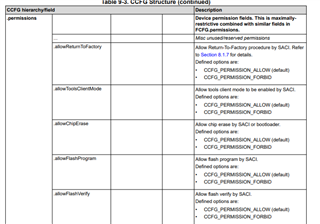

I reviewed the Technical Reference Manual and found that CCFG and FCFG sectors can be protected using the following commands:
.flashProt.writeEraseProt.ccfgSector = 0 And.flashProt.writeEraseProt.fcfgSector = 0.  but it did not work.
However, I noticed that the CC2340 ROM bootloader does not support a sector erase command, only a chip erase command, which unfortunately erases the CCFG sector as well.
Could you please advise if there is a supported method or workaround to safeguard the CCFG sector during flashing? I want to ensure the application can be reflashes multiple times without losing the bootloader configuration or encountering an unrecoverable state caused by CCFG erasure.

    I hope you are doing well. Addressing your first question/concern "and I am subsequently unable to re-enter the serial ROM bootloader mode." what happens here is that if the CCFG is erased the device does not know its configuration, in this case what's likely happening its that its defaulting to the default bootloader IO pins and index (FCFG) as defined in the TRM rather than the ones you set.
    Due to security reasons the serial ROM bootloader is an all or nothing approach, meaning we cannot sector erase we either erase the entire device or don't use the serial ROM bootloader.

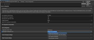

  • Hello Muthu raj,
    We provide an MCUBoot example already in the SDK, so I would recommend customers start from there.
    (C:\ti\simplelink_lowpower_f3_sdk_9_10_00_83\examples\nortos\LP_EM_CC2340R5\mcuboot)l
    We control various aspects of the CCFG and the bootloader in syscfg, as an example below here is where we can change bootloader:
    Alex F
