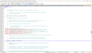

    Could you please provide me with the actual measured value of the time it takes for the device to enter standby mode after the termination process is complete?
    Let me reachout to my team and see if we can get these numbers.
    Nima Behmanesh
    So the time it takes to enter standby is configurable by the power driver. Looking at the description for the default power policy in C:\ti\simplelink_cc13xx_cc26xx_sdk_8_30_01_01\source\ti\drivers\power\powerCC26XX.h:
    You will need to look at the power policy that is set in sysconfig, and change or create custom policy.
    You can find more information about the Power Driver here: Power.h File Reference
