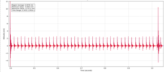

So my team members and I have been trying to determine the lowest power consumption of the TI-CC2652R7. We started off with the project_zero example and instead of launching the project_zero thread, we launched a test thread and stopped at the semaphore. When we do our power measurements, we get an average of 9 uA. However, according to the data sheet, we should be getting 0.9 uA in Standby. I understand that there might be something wrong with our circuitry, but if you can confirm that my approach to entering the standby state is correct, that would be greatly appreciated.
