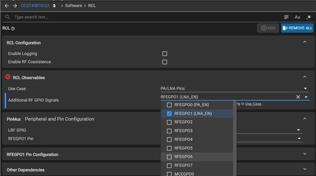

Monitor PA/LNA is very convenient to debug wireless issues, but I have a user case that the IO is limited or the space for the debug port is limited and I want to only monitor PA or LNA, sysconfig informs ERROR.
It's not allowed only map PA or LNA to the PINs. Do you have a method to do it?
  • Hello Island,
    Please unselect the PA/LNA on the "Use Case" tab. Then select the desired output for the additional RF GPIO Signals. See the image below:
    This will allow you to output one signal at a time. This worked for me. Let me know if you have any problems.
