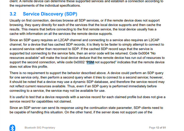

Hi TI Team,
We are currently facing an issue during PTS (Profile Tuning Suite) testing, specifically with the IOPT Class of Device test case. The test is not passing, and we are observing the following key point in the logs:
Invalid PSM values 0x0002 selected.
We would like to understand the following:
  1. Is the PSM value 0x0002 configured or managed internally by the Bluetopia stack?
  2. If yes, where can we verify or modify this value in the stack configuration?
  3. Could this be influenced by any IXIT settings in the PTS tool.
We are attaching the complete testing log for your reference and analysis.
Looking forward to your guidance to resolve this issue.

    Verdict Description:     Invalid PSM values 0x0002 selected
    Does this line mean that our device sent a PSM value of 0x002, or that SDP (service discovery) failed.
    https://files.bluetooth.com/wp-content/uploads/dlm_uploads/2025/07/IOPT.TS.p14.pdf
    This option seem more plausible to me as we dont set any PSM value to 2 in any of our profiles and also even psm values are not allowed by btsig.
    Does the test logs also provide snoop logs that you could see from a bluetooth analyzer software?
