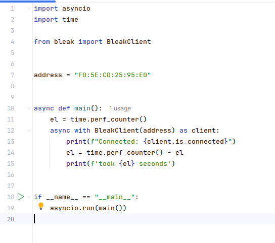

The python code to test such BLE connection is simple and it comes next, I don't think this is the culprit.

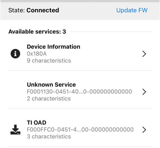

I used the simplelink connect app which seems to connect FASTER. This is the service table on the device. It does not seem excessive.
I have read this slow service discovery might happen if some characteristics / services are wrongly indicated but I dont think this is the case. 2 of this services are from TI. My "unknown service" is 2 chars long.

  • Hi !
    It looks like your BLEAK python library is indeed performing a complete GATT lookup upon connection before entering your python callback with the prints.
    This will significantly reduce the performance, as it needs to perform service discovery, then attribute discovery, and then attribute description discovery. You can see that BLEAK is doing this because the logs receive in a very short amount of time all of the services, attributes and attribute description.
    The reason why BLEAK is doing this is because the API does not provide any function to discover those services and characteristics. Services are a field of the BleakClient class, which can be read at any time. Therefore I don't think it's possible to change this behavior.
    The only central-side solution I would see if you insist on using BLEAK is to use the services parameter of the BleakClient class. This would allow you to specify which services to look for. This may speed up the connection according to the docs.
    Another solution is to lower the connection interval and to set a higher MTU on your CC26X2R1.
