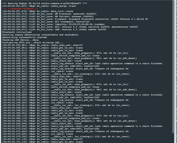

I have a problem with CMD_BLE_ADV that I can't run down. I am chaining three advertising packets and see the proper advertising packets sent (using WireShark) . I resend the chain of three every 30 msec and this can continue indefinitely. So far, everything is great.
The problems begin when a SCAN_REQ is received. The CPE transmits a proper SCAN_RSP (as verified by WireShark and the iPhone app which sent the SCAN_REQ). My advertiser call-back is notified with event "RF_EventRxEntryDone" (as requested in the RF_postCmd). The data in the received buffer matches the data shown on WireShark. I subsequently get a "Last Operation in chain finished" event callback with a  normal status.
When I examine the data queue (in debugger) I see the first buffer holds the SCAN_REQ data and the rx_queue "pCurrEntry" now points to the second buffer. My call-back resets the DATA_ENTRY_FINISHED status back to DATA_ENTRY_PENDING after printing out the contents. My rx_data queue is a 4-entry circular buffer.
So far everything seems normal. However all subsequent CMD_BLE_ADV commands to the CPE terminate with "Invalid Parameter" (and no transmission of advertising packets).
I have attached the business code from my `radio.c` and debug screenshots showing 1) advertising working  and 2) advertising failing after receiving SCAN_REQ.
As noted in comment, the setup code is the unedited "smartrf_settings.c" generated by studio7
All of this running on LP_CC2652R7.
