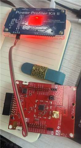

We are a module manufacturer.
We are now using TI CC2745R10 LP to verify the power shutdown current.
We use the SDK simplelink_lowpower_f3_sdk_9_10_00_83.

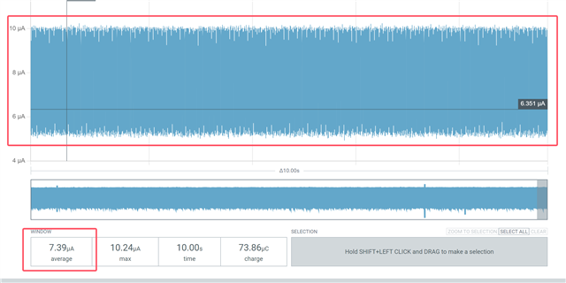

We call the following program and measure the current from the power monitor, which is 7uA.
How can we reduce the power consumption to <1uA?

    That seems to be the same power usage of the external flash. You may need to cut the trace that connects to the external flash to get a more accurate power measurement.
