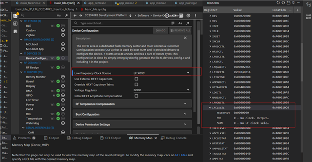

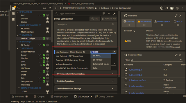

Hi Forum,
  We are trying to explore the "Low Frequency External Clock Source" options for CC2340R5. As we can see in sysConfig by default the option is "LF XOSC" which means module is expecting clock from external source BUT in our current module we don't have this external crystal populated and module is still working fine. So, Does this configuration in sysConfig is even taking effect?
My other query is, If i  were to use external low frequency clock source, then what should be the configuration in sysConfig.
Vaibhav
  • Hello Vaibhav,
    I hope you are doing well. I wound recommend checking the register LFCLKSEL in debug mode, as this is what controls the LF clock source here, this can tell us if its selecting the right clock source.
    Alex F
  • Hi Alex,
    May i know how to access this register? I could not find base address this register in Technical Reference Manual ?
    Vaibhav
  • Hello Vaibhav Patil,
    Looking in the SDK I think we can access it like:
    HWREG(CKMD_BASE + CKMD_O_LFCLKSEL)
    #define CKMD_BASE               0x40001000 // CKMD
    // Low frequency clock selection
    #define CKMD_O_LFCLKSEL                                             0x000000C0U
    Alex F

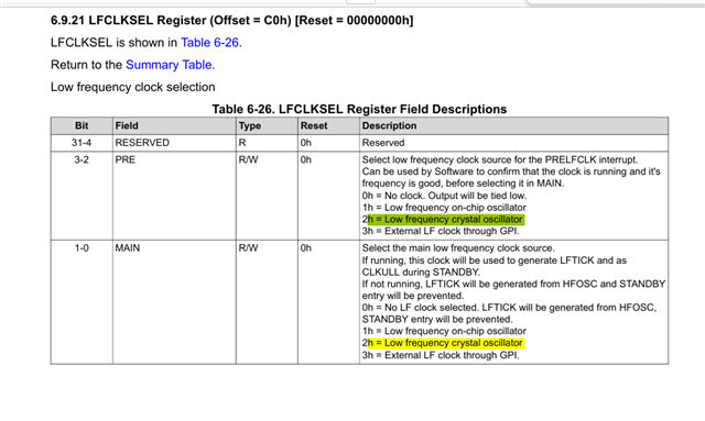

  • Hi Alex,
    As per the datasheet when we select "LF Frequency Clock Source" as LFXOSC, we should register value 02H. Then why in this case i am getting 00H? Please let me know am i understanding this correctly?
    Vaibhav

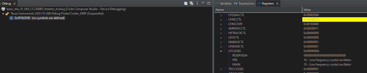

  • Hi Alex,
    To give you context of how i did  is, i took basic_ble project, added break point in app_main-> appMain(). I believe app_main is called after board_init, so i was expecting register to be initialized.
    Vaibhav
  • Hello Vaibhav,
    I imported the basic_ble project as well (9_10 F3 SDK) and while the LFCLKSEL was initially "00" after board init, it then was configured to "10" (after pressing play then pause).
    Alex F
