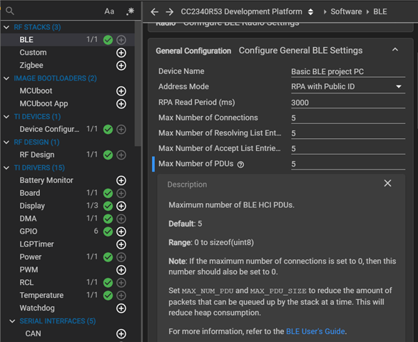

    I did not receive any update on my end. I delved deeper into your issue, and error code 4 for the GATT_Notification function is associated to MSG_BUFFER_NOT_AVAIL. This error happens when there is no HCI Buffers available anymore for the BLE Stack to allocate space for a notification.
    You can increase the amount of total buffers used for BLE by increasing the "Max number of PDUs" in sysconfig here :
    Kind regards,
    Maxence

    I'm using SysConfig, which is a tool developped to easily configure the board that you are using, but in the picture I was in a CC2340R5 project and not a CC2640R2 project. This tool is not available of the CC2640R2, my mistake.
    For your initial issue, changing the max number of PDU is not as simple as changing the define in ble_user_config.h under ICallBLE. You also need to follow the instructions at the top of the file to include your custom configuration, which require additional steps :
