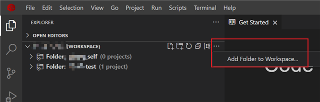

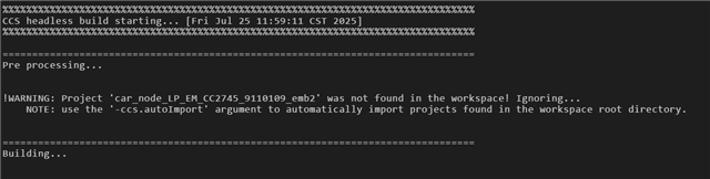

I use CCS 20.0.1 to build the project via CLI. When I use the project reside in the default workspace_ccstheia it can be done, but when I make a folder under the default workspace and copy the same project into the folder, the console shows cannot find the project. I also use the GUI, it cannot build as well.
The reason I request this is that we have a team and share the workspace but need to have separate folders for different branch.Do you know how to build it by CLI in the different folder?
