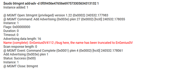

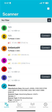

    $sudo btmgmt add-adv -d 0f09456e47656e697573305634313132 1
    Instance added: 1
    @ MGMT Open: btmgmt (privileged) version 1.22 {0x0002} 240532.177983
    @ MGMT Command: Add Advertising (0x003e) plen 27 {0x0002} [hci0] 240532.178055
    Instance: 1
    Flags: 0x00000000
    Duration: 0
    Timeout: 0
    Advertising data length: 16
    Name (complete): EnGenius0V4112 //bug here, the name has been truncated to EnGenius0V
    Scan response length: 0
    @ MGMT Event: Command Complete (0x0001) plen 4 {0x0002} [hci0] 240532.178061
    Add Advertising (0x003e) plen 1
    Status: Success (0x00)
    Instance: 1
    @ MGMT Close: btmgmt

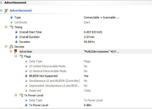

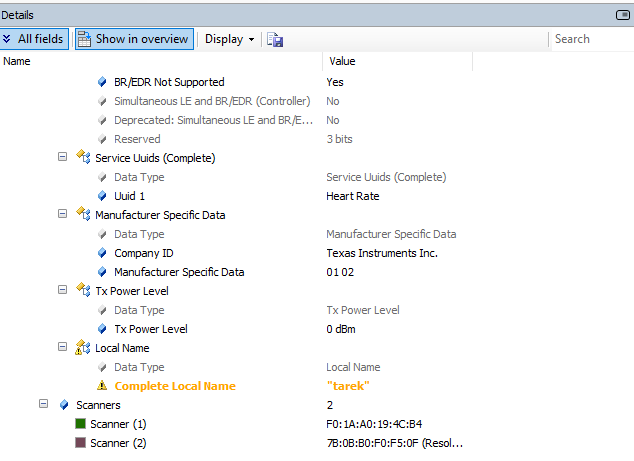

  • Hello George,
    Thank you for your patience! I went through the process on my end and I was able to get the device to include manufacturer specific data inside the advertisement reports (see packet sniffer screenshot below). My setup also used Ubuntu and BlueZ 5.64.
    To do this, I opened btmgmt using "sudo btmgmt -t hci1" and ran the following:
    power on
    le on
    connectable on
    sc off
    advertising off
    add-adv -u 180d -d 050d000a0102 1
    name tarek
    advertising on
    This will create a service UUID (heart rate), set manufacturer specific data, with TI's company ID (0x000d) and send the data 0x01 0x02, and set the name of the device to "tarek".
    It's worth mentioning that there may be an issue on the bluez side, as I too was unable to set a name longer than 10 bytes, even though the BLE spec supports names up to 31 bytes.
    Please let me know if this works for you!
    Tarek D

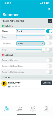

  • Hi Tarek,
    I would test manufacturer specific data and reply th result later. And what I am confused is that the name comes different result from btmgmt and bluetoothctl.
    Here is the screenshot when I'm controlled from bluetoothctl and it seems not limit by 10 bytes. But using bluetootctl I would encounter an issue that advertising off cannot be control via bluetoothctl. And at the meantime, I want to use the btmgmt to control the advertising off then the name got be truncated.
    As you could see below log and screenshot , FrankDevice is more than 10 bytes.
    $sudo hciattach /dev/ttyACM36 any 115200
    Device setup complete

  • Hey George,
    I looked further into the name size limit issue. I believe this was a BlueZ design choice, limiting the name to 10 characters to leave space for other data inside the advertisement reports. However, one way to bypass this will be to manually adding the name throught a btmgmt command as seen below:
    advertising off
    add-adv -d 11094d79424c456465766963656565656565 1
    add-adv -n 1
    advertising on
    Here, the add-adv commands represent the following:
    • For add-adv -d 11094d79424c456465766963656565656565 1
      • 11 represents the number of bytes being sent (0x11)
      • 09 is the flag for complete local name (0x09)
      • 94d79424c456465766963656565656565 is "MyBleDeviceeeeee" which is 16 bytes
      • 1 represents the advertising set
    • For add-adv -n
      • Adds the local name to the scan response (this step may not be necessary)
    By running this command, I was able to see the full name on a packet sniffer log(screenshot below). I would also like to point out that this is a limitation on the BlueZ side and not an issue with the TI device or firmware.
    I hope this answers all your questions!
    Tarek D

  • Hello George,
    When I tested this on my end, my observation was that the name will remain the same (EnGenius0V4112), however, the actual name will change when checking with a packet sniffer. I also noticed BlueZ sometimes did not send the command right away, so I had to send the same command multiple times for it to actually send the HCI command to the CC device.
    I would also attempt to use a different advertising set and see if that causes a change. So the command would become:
    add-adv -d 11094d79424c456465766963656565656565 2
    Tarek D
