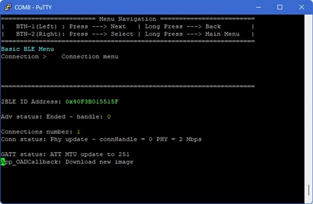

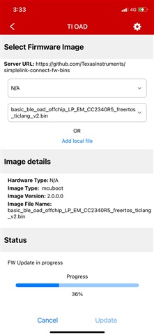

test method: CC2340R5 EVM <-> Smart phone, send 500KB binary from smart phone to CC2340R5 EVM
test time: it cost 118 second (34Kbps)

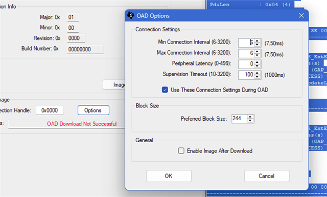

PS:  PHY: 2M, PDU size :251bytes,
They also try to use two CC2340R5 EVM to run OAD,  but it still cost the same time.
The following is the connection setting at BTOOL:
